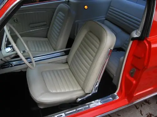

OMG. Not even close. Looks like a disco nightmare. And a Pinto steering wheel. How do you blow the horn? Your door handles are at the wrong angle, the ones below are correct.
"White Crinkle Vinyl with Black Appointments" means the seats are white, the doors are white, the door panels are white, the arm rest pads are white, the headliner is white, the seats are white, the visors are white, the quarter trim panels are white, the dash and steering column are white, the steering wheel is white, the A pillars are white, the console, if equipped, was white. In fact, the only items in the entire interior that were black were the package tray, carpet, seat belts, and dash, period.
This is a fastback, but you get the idea.
