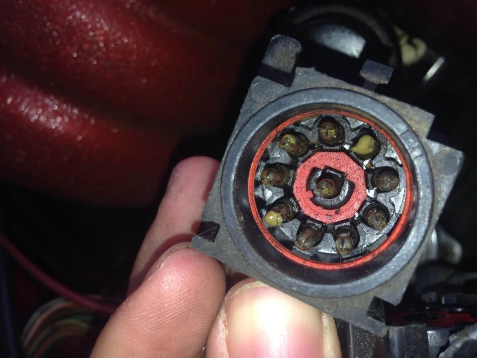

I have been having a misfire problem with my car for a while now. Blows black/white smoke with strong smell, car shakes, and misfires at low rpm/ rough idle. Also a very good amount of power lost when not misfiring. I changed the MAF sensor because I thought this was the problem and it actually worked for a day now it is back to its old ways... Here's a video View: http://youtu.be/kpFq7qU81nA
Also could you explain these codes to me a little better
Got codes 21, 22, 24 35 51 53 54 66
For KOER got 11- system ok
For Cylinder Test I got 90 aka cylinders are all good

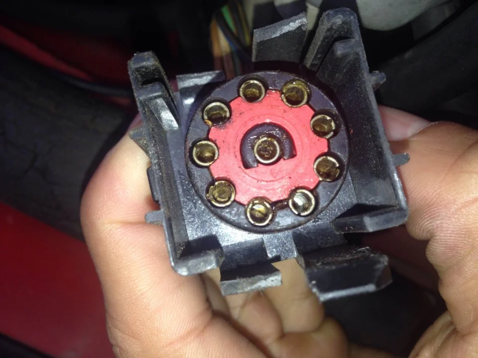

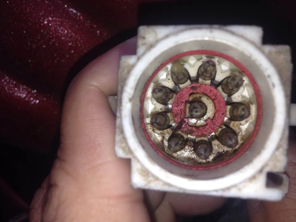

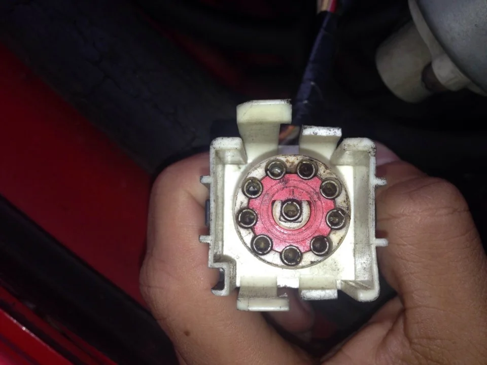

Having all of those codes generating from the engine harness, I'd suspect the 10 pin connectors. Run a search for 10 pins here on the forums. They will need pulled apart, cleaned, and pins adjusted for better contact. Very common issue
Reactions: A5literMan, Daliceo, mikestang63 and 1 other person

Thanks guys, I really appreciate the help. Okay I'm gonna start off with cleaning and checking the 10 pin connectors to see if that will help any and get back to you all as soon as possible

Going to get cleaner today but i just wanted to check them out before doing so and they look pretty dirty to me

Spray them and connect/disconnect them a few times. I like to put di-electric grease on them when they go back together for the final time.

Take a q tip with some parts cleaner and clean out all of the connections. You may need to use a small pick to tighten up some of the connections. Put some dielectric grease in all the connection holes when you reassemble. If you have the jumpers that were installed from a TSB remove them- they are just another set of connections to go bad.

Cleaned the 10 pin connectors and tightened connections, nothing changed. What should I do next?
