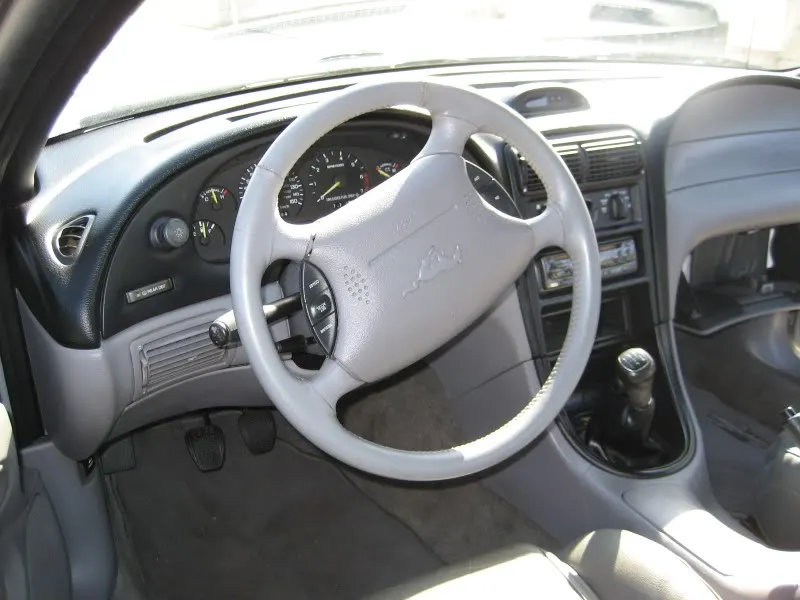

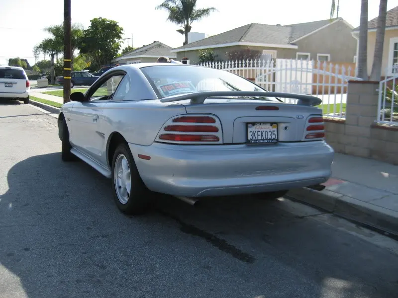

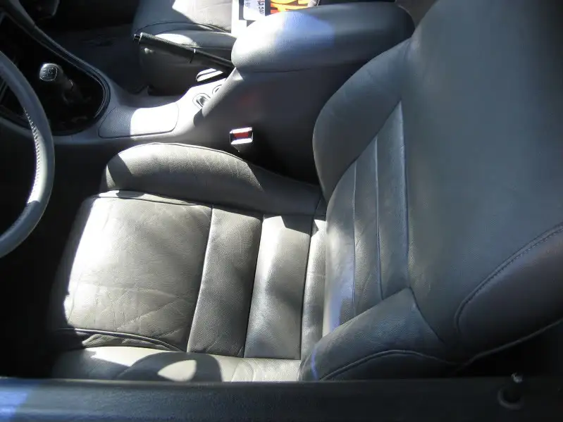

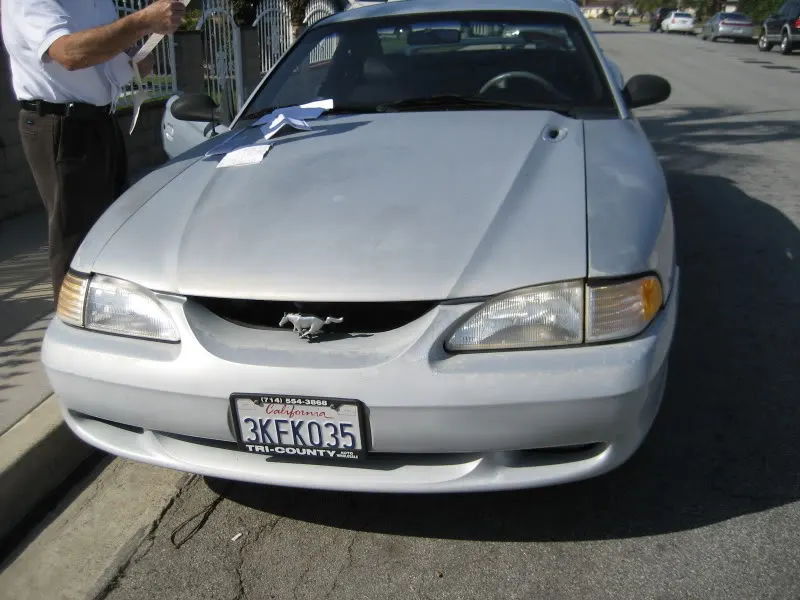

A couple of pics I took on Sunday when i looked at it. I paint so the front end will be redone very quickly. so WOO! im kind of excited. This will be the 10th car I've owned. They have all been Ford products yet it will be my first Mustang.
