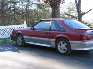

That car in those pics is definately NOT lowered 3 inches. Here is one of mine at not even 1.5!

That is what I thought too. I thought it was only a couple of inches at the most. This car was originally listed on eBay for sale and there was no mention in his auction about it being lowered either. Here is the thing..............the car is MUCH lower than it looks in the pictures. I think he purposely took pictures from the angles that made it look the least lowered. That concerns me. My biggest fear is that it really wasn't lowered correctly and that there were some things cut. It is probably about as low as your car with the 1.5 inch drop.

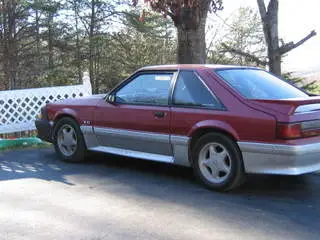

Here is a pic of the one i just got all the parts for, it looks almost as low as the one in your pics, but to answer your question, just swap in some stock springs

Well you'd just have to do everything backwards. ha. When you lower a car, you can put on shorter endlinks(holds sway bar), lowering springs, camber/caster plates, and Offset steering rack bushings. Really not that hard to put orignal back on. If you really like the car and want it. Id go with it. Putting in the stock springs, camber/caster plates, and steering rack bushings isn't hard. So don't let that hold you back. Plus any mustang junk yard or on ebay you could get some stock springs, camber plates, and steering rack bushings. They couldn't be bringing much ha. Not many people are looking for stock suspension. You can buy new Steering rack bushings that are right for you car. Just pick up stock springs and camber plates on ebay for cheap and your good. Car looks really clean by the way. Good starter project!
