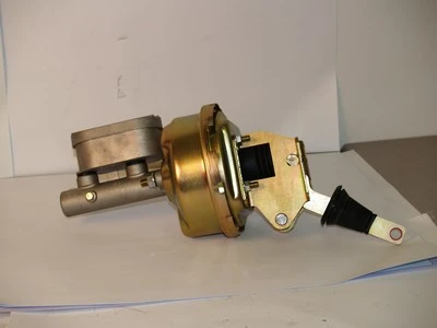

I am leaning toward the hydraulic clutch setup. The problem that I may have is that I am using power brakes. The power brake setup came from Master Power Brakes. While the power booster uses a bracket that moves the booster about 3" away from the firewall, I am not sure if there will be enough clearance to install the hydraulic master cylinder through the hole used by the original clutch linkage.
If anyone is using the Master Power Brake power booster and a hydraulic clutch then please let me know if you had any install issues. A picture of brake booster is below.

Do your homework for sure. I have power brakes as well and I spent considerable time researching to make sure I got the right brake booster which would fit with the hydraulic master. I am sure ther is a solution available, spend some time searching the forum, there are a lot of threads on hydraulic clutch setups. He'll, I probably posted 10 questions when I was doing research and having trouble bleeding the damn thing:D
