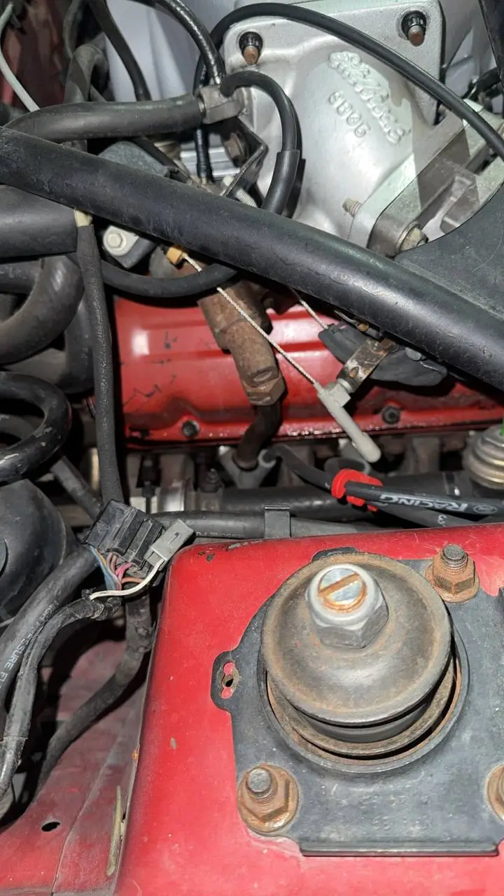

I have that pipe from what I know. I’ll look tomorrow to make sure! The pipe I’m missing for sure though is coming off of the exhaust manifold on the passenger side and goes directly into the EGR?

it’s sold. But thank you! I did manage to find the part on oem ford parts somehow. Expensive but it will fix some codes hopefully and help me pass emissions. Anyone know why one bank ran lean and the other bank ran rich? It’s making me nervous.

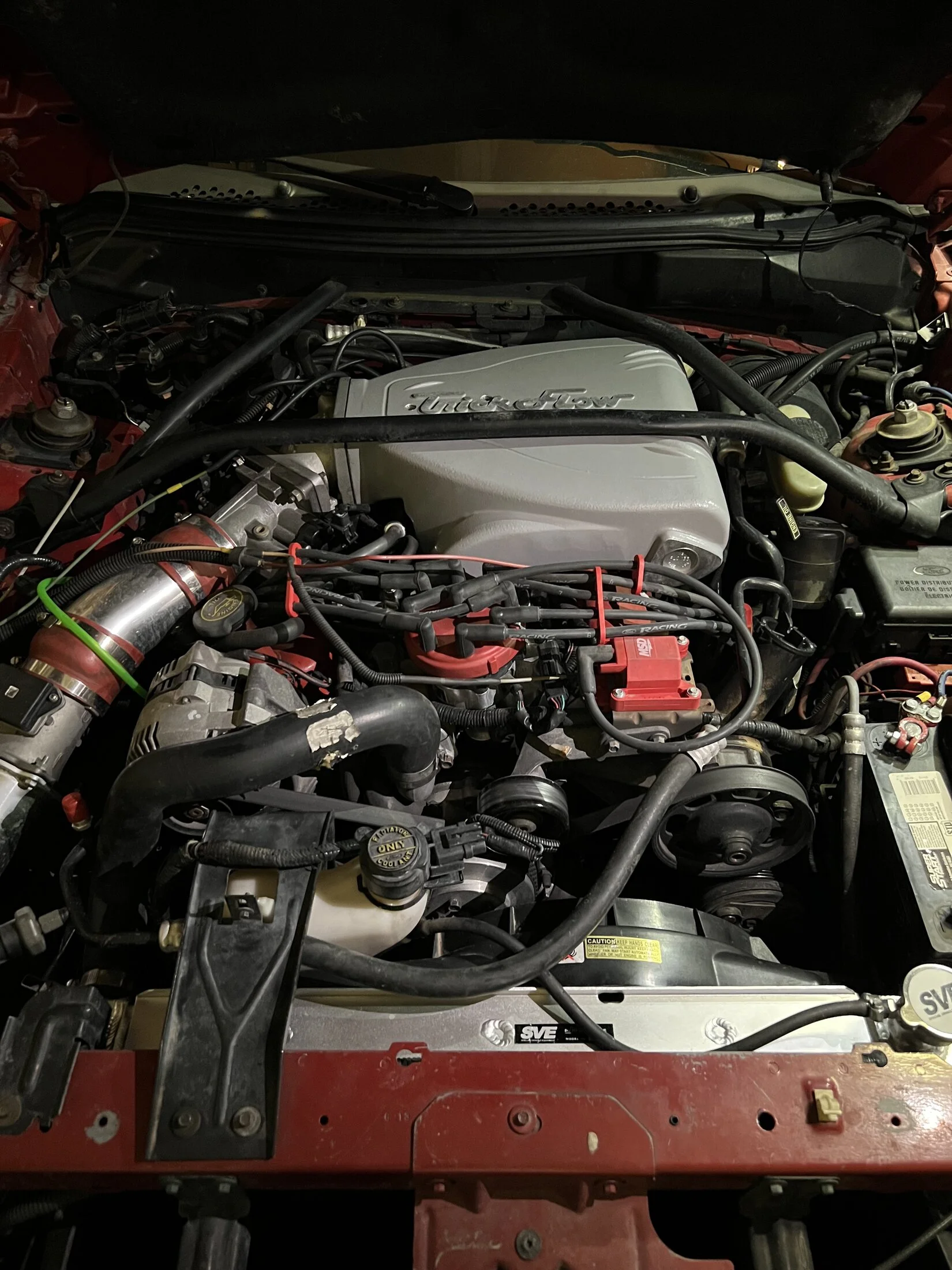

Here are the engine bay pictures.
From the looks of it the original exhaust has been cut and some things have been welded on. I will have to verify the cats are not gutted.
I can verify the smug pump still has the belt around it. From what I know the EGR stuff is still there.

Ok, so good news. Cleared the codes, then scanned them with a code reader this time and in the proper procedure. I think a lot of the codes I got originally were false due to the engine not being at operating temps while doing the KOER test.
The only codes I got back were 121 (KOEO and KOER) then I got codes 137 and 173 (KOER).
so with that narrowed down a lot more, my plan is to get the EGR system back up and running so it will throw a code and the computer will properly adjust the fuel and timing and not use the EGR system. Just for the time being until I can get that tube.
The car has some weird stumbling or surging at idle but its rare. My guess is the EGR or the ICV needs to be cleaned.
