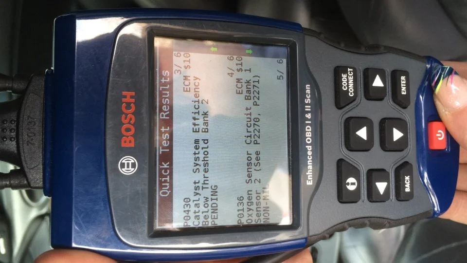

See attachment.

System efficiency below threshold bank 2.
must be another exhaust leak I missed. I'll check the back in when I do fuel filter this weekend
And O2 sensor bank 1 sensor 2.

p0430 talks about the cats which I'm betting you either don't have or they are not functioning correctly if you do.
