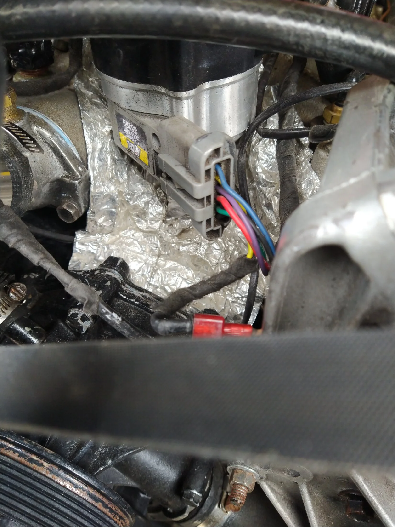

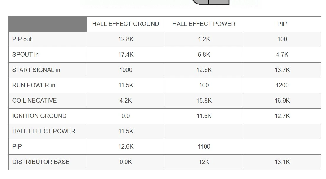

When you look at this pic on doing a TFI module test notice theres a test that involves the grounding plate that mates with the distributor called distributor base and is supposed to have cooling compound between both to transfer the heat.
When the thermal compound gets hard and crumbly the TFI module loses its ability to properly transfer heat and causes the TFI module to fail..
Another thig I found out is that cast iron distributors bleed off and retain less heat than billet aluminum ones...
And a simple device like this stops the TFI module from being heated up from the engine block and waterpump when youre relying on just an electric fan..
