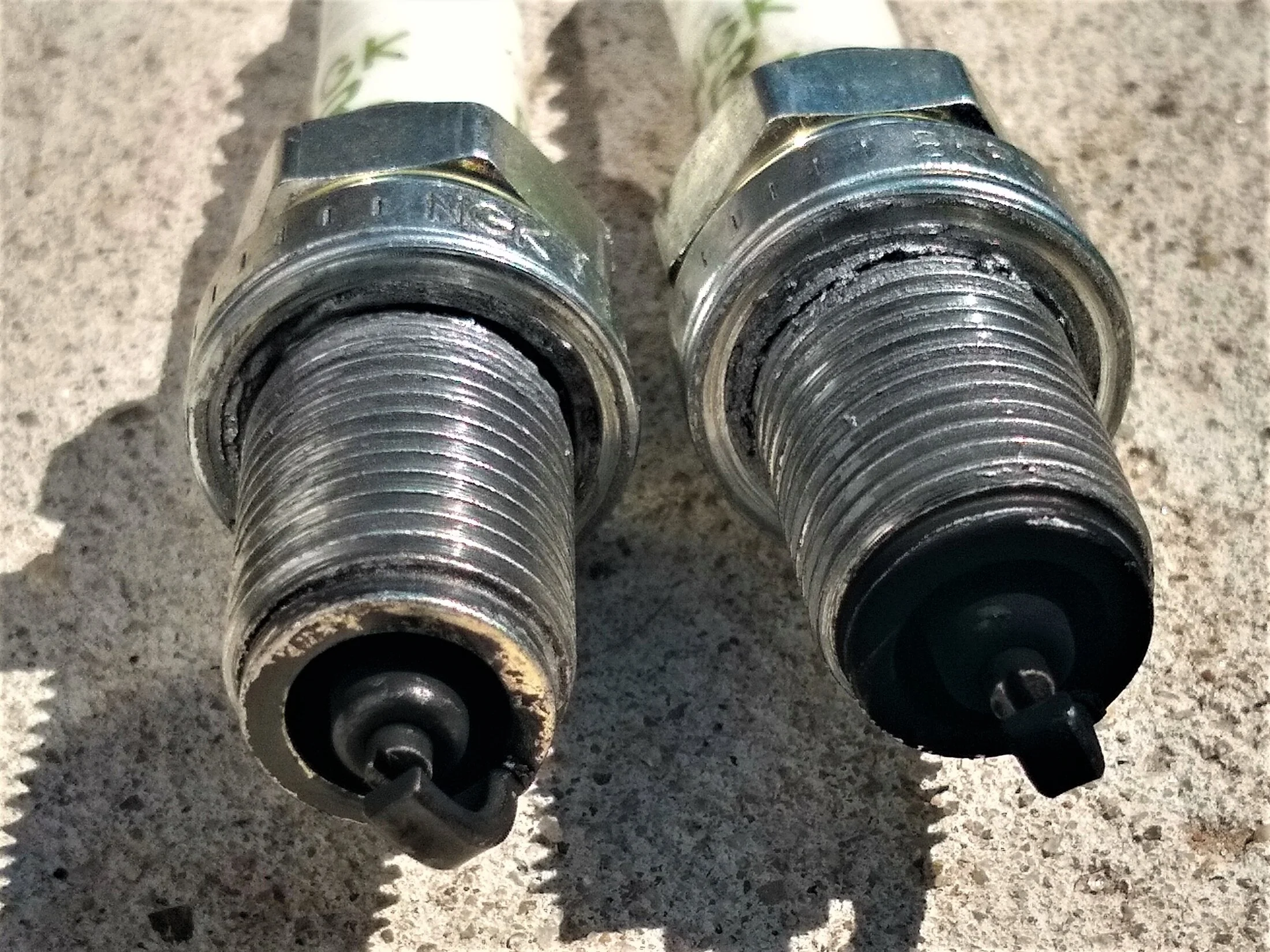

If you know how to read spark plugs that helps. But you will have to shut off the engine at the end of a WOT run to get real plug readings. By the time you drive back to the shop or home, any plug reading at WOT is gone. You read the ground strap on the plug for timing and the first thread on the spark plug for fuel rich/lean
Ok thanks, I'll give that a go. I actually just pulled a plug the other day just to get an idea and the ground strap was white-ish (I'm guessing a little hot from too much timing?) and the first thread is black from the car running rich for a while (think I have that dialed in much better now).

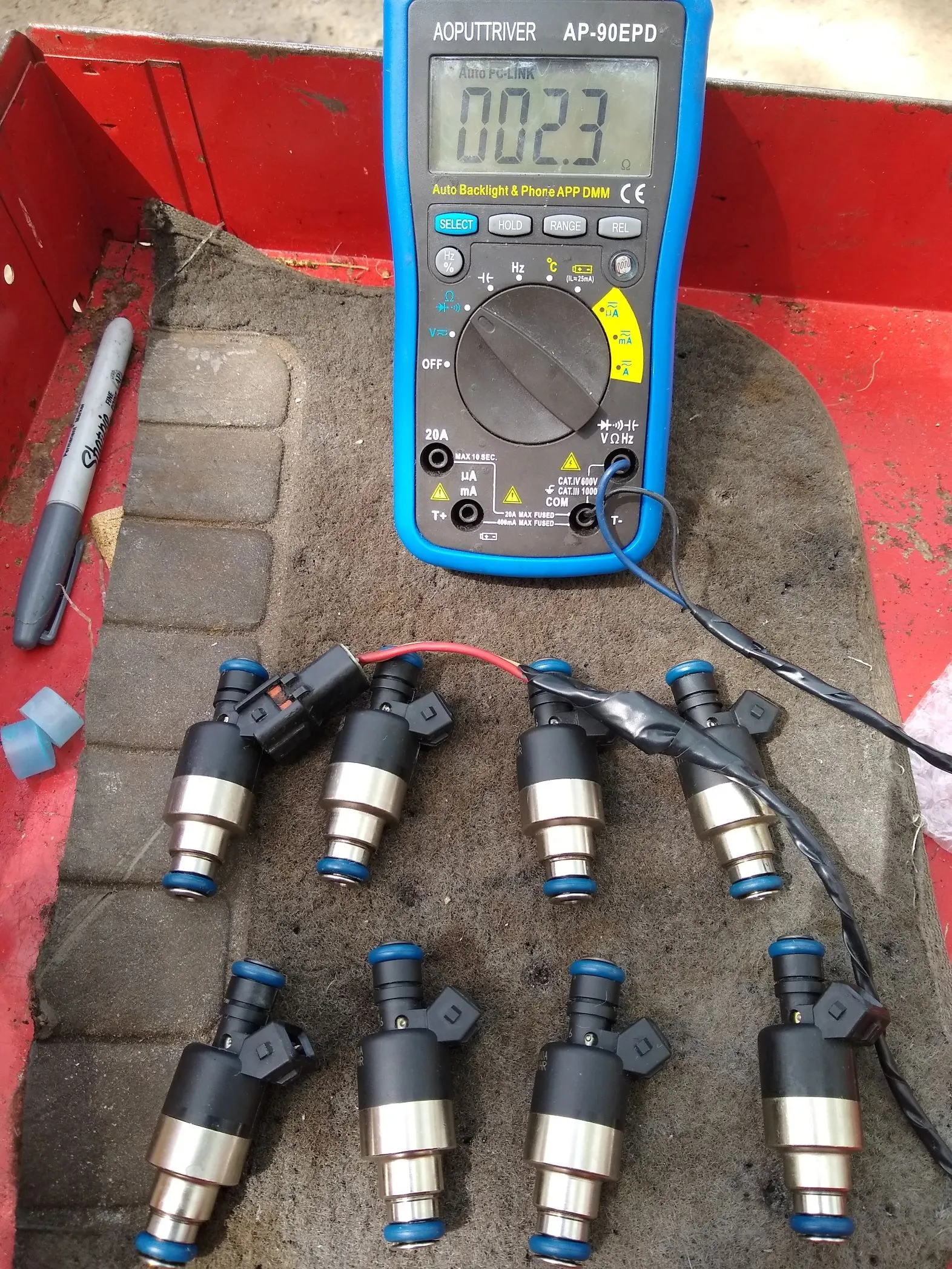

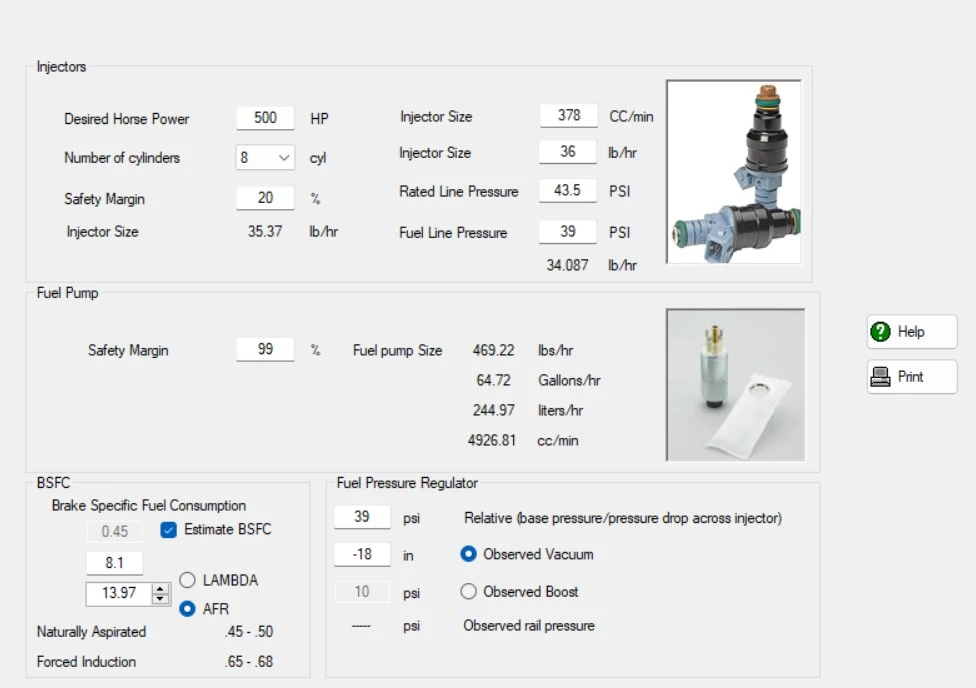

Your fuelpump is the issue...............No matter if you have a fuelpressure regulator thats adjustable the LPH is whats working against you with the injector pulsewidth..
With my 410w w/36's and a 255 pump in the tank I had to drop the pulsewidth of the injectors to half in order to get the correct amount of fuel per pulse .
When you experiment with a Holley bad things can and will happen ..
Make sure you keep an eye on the oil level....

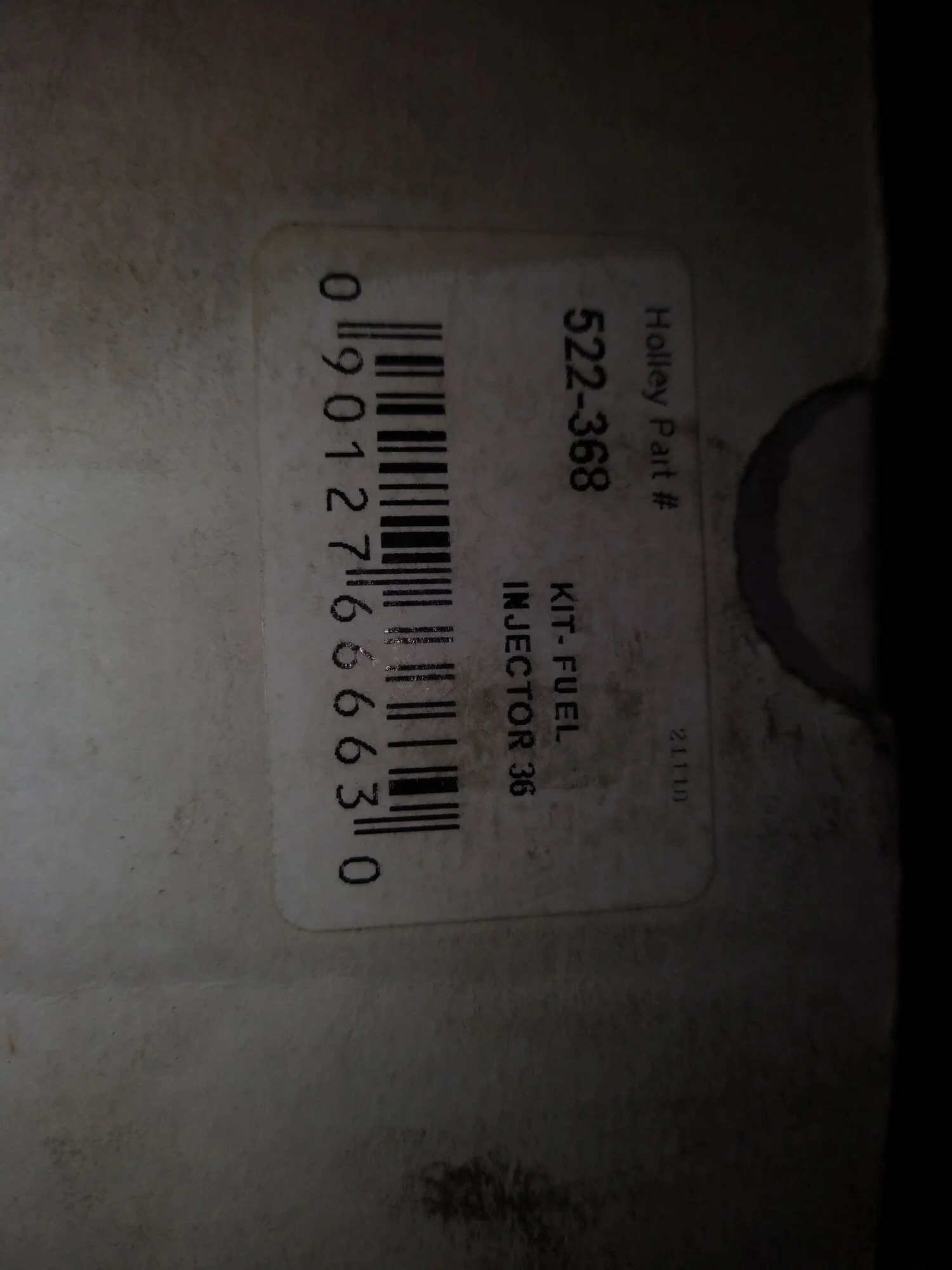

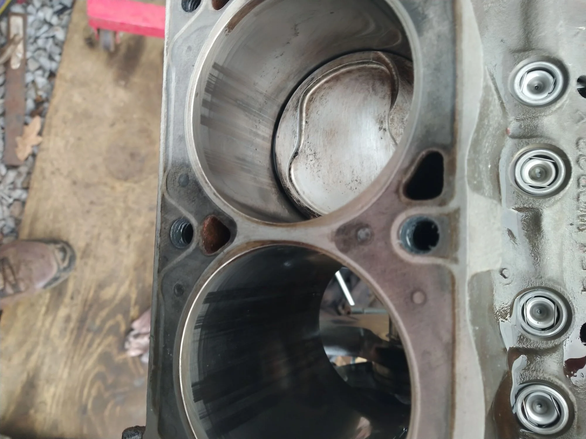

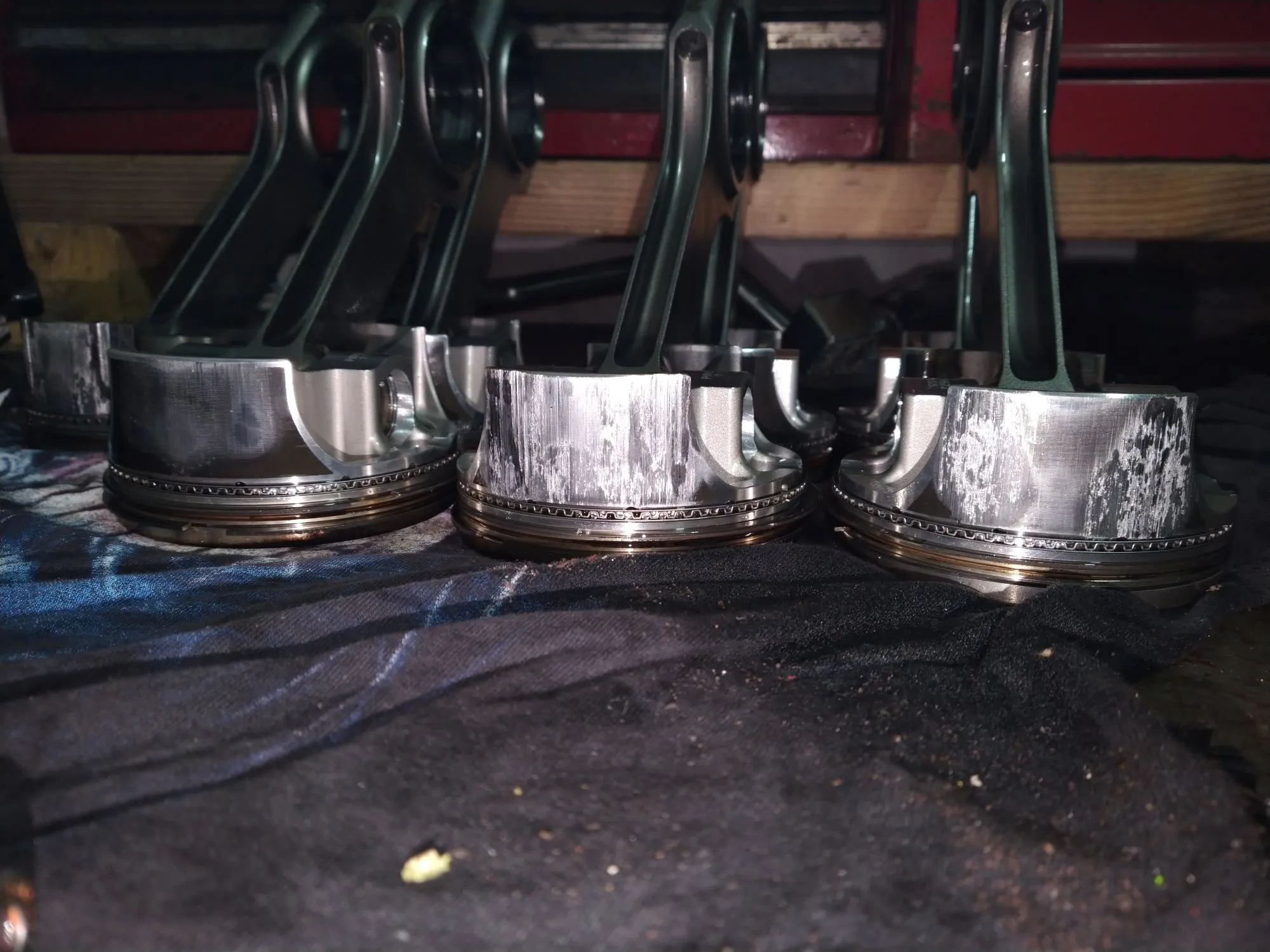

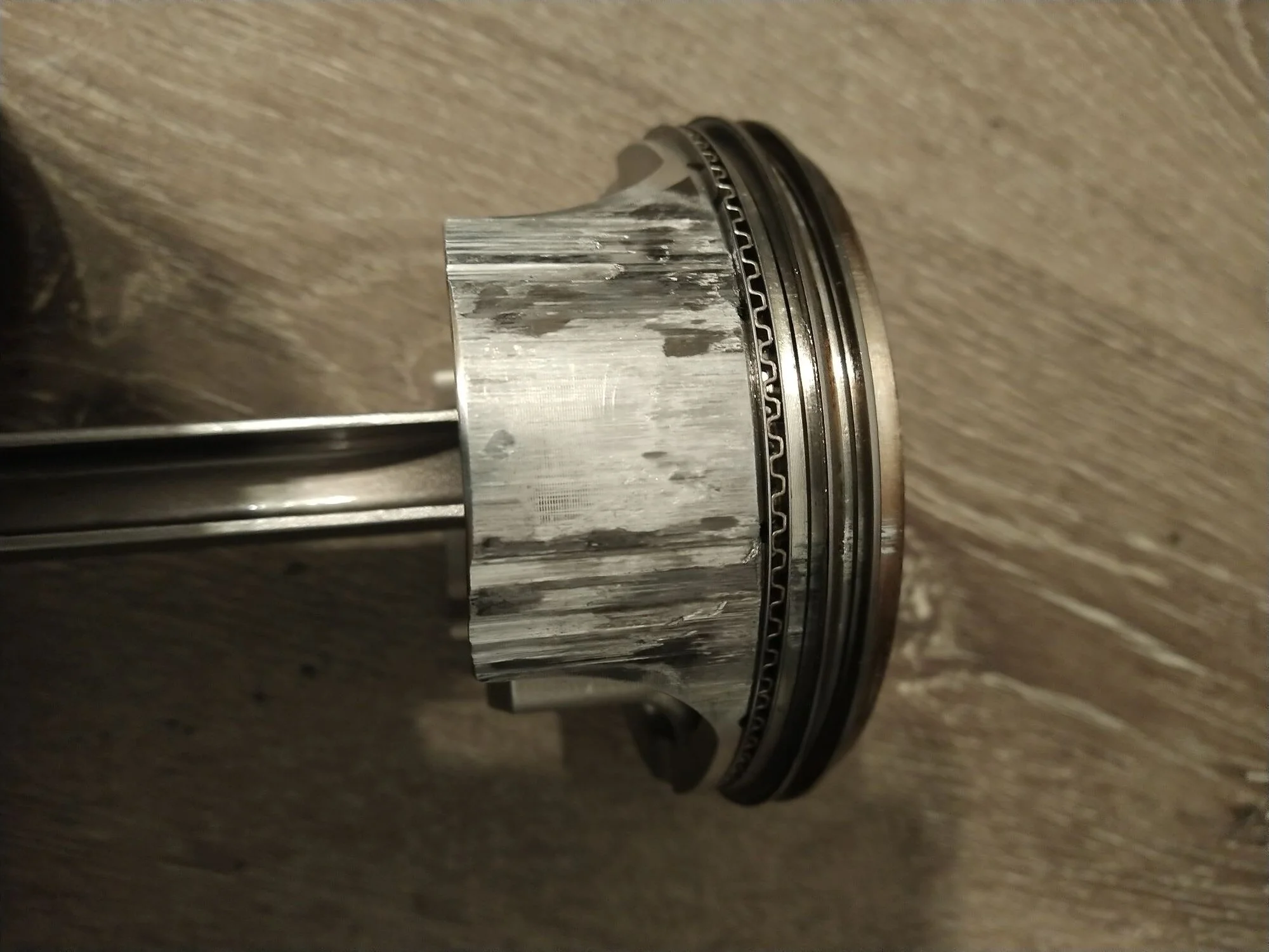

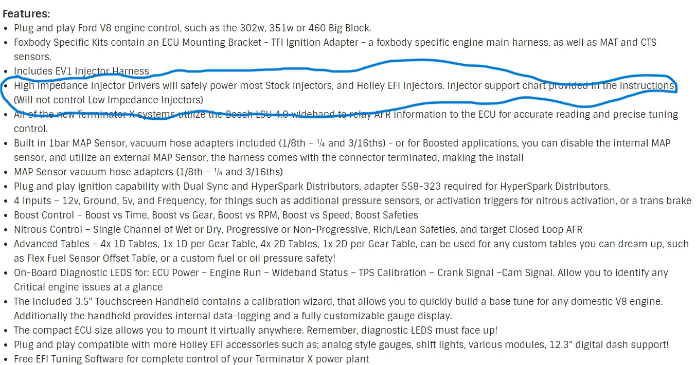

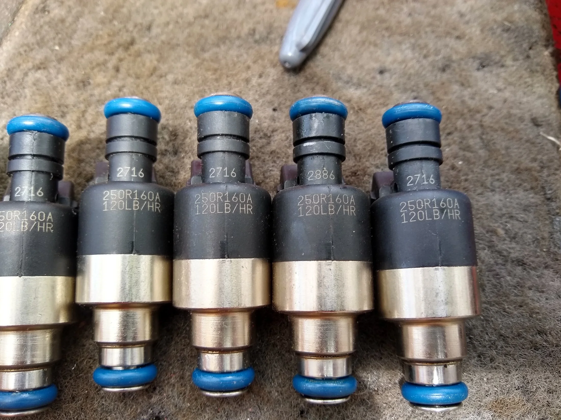

The oil level got higher on mine which gaswashed all of the cylinders in m 408 which wasnt my fault because my system wasnt supposed to run low impedience injectors and Holley sent me low impedience 120lb injectors improperly packaged inside a 36lb box which destroyed my engine and all they did was lawyer up and block my email addresses...........
Whats even funnier is Holleys Forum Vultures who sit and wait to prey upon people who are experiencing tuning issues offering their services for a fee promising positive results but not 1 Supposed TUNING Pro couldnt read a logfile to figure out I had injectors that were way too large and shows they werent technical enough to read a logfile but took a majority of my money promising bs then saying my issues were in my wiring etc having me chase my tail.........
I even had my tune looking good at idle until I hit the gaspedal then all hell broke loose....
