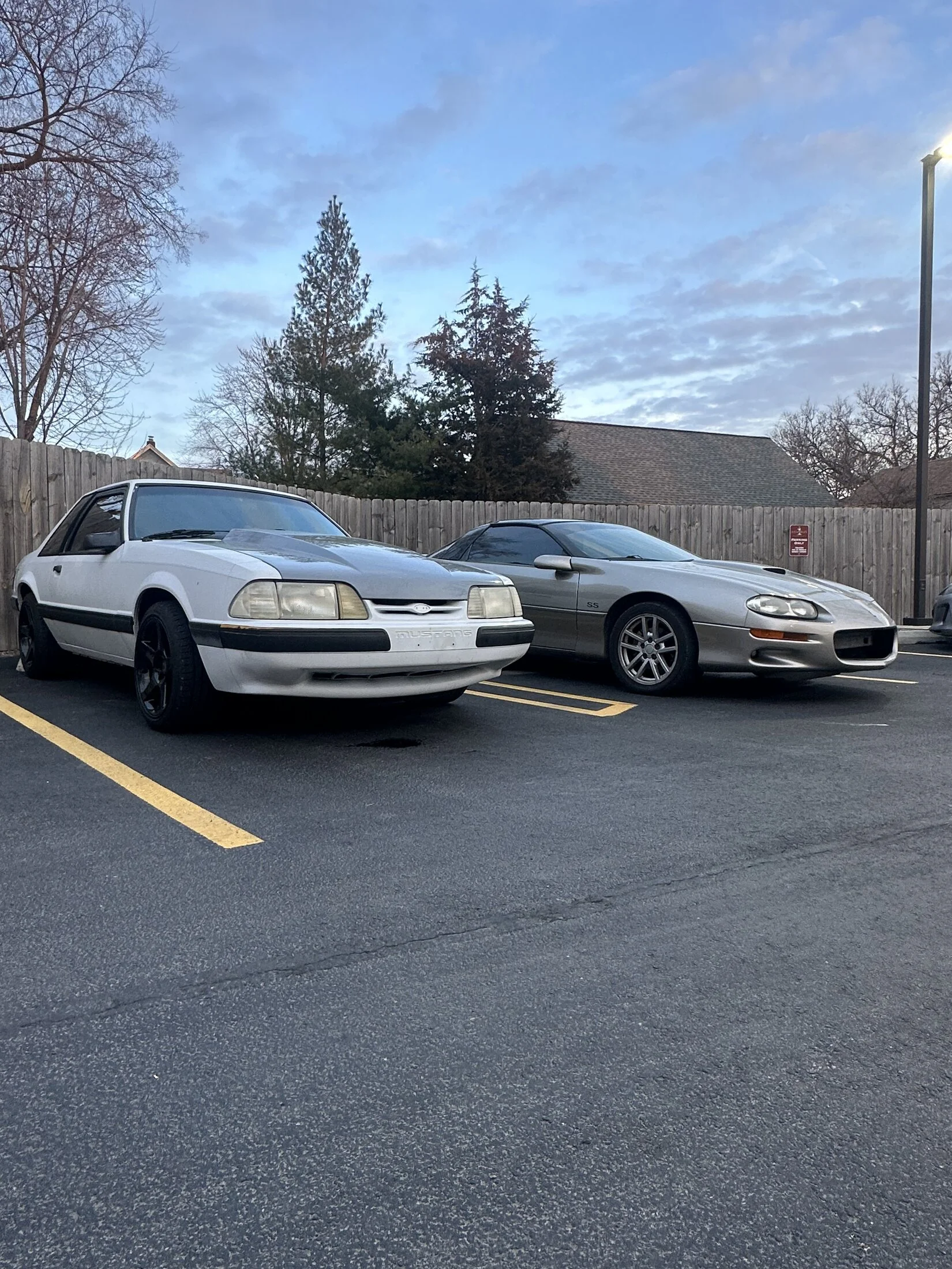

Posting bc all the research I’ve done nothing came up with this combo of broken parts.
started right up. Threw check engine light.
Weird.. I pulled the IAC off while it was idling. It killed the engine. Plugged it back in and it’s been running great since. No codes no check engine light. Thanks to this sight for the past 2 decades of informantion
