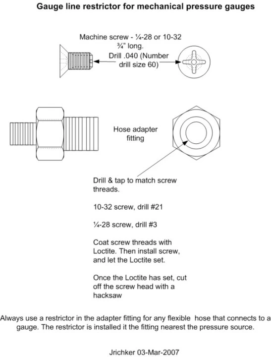

i was told to do this to slow the oil down if something breaks so u dont pump out all your oil.
