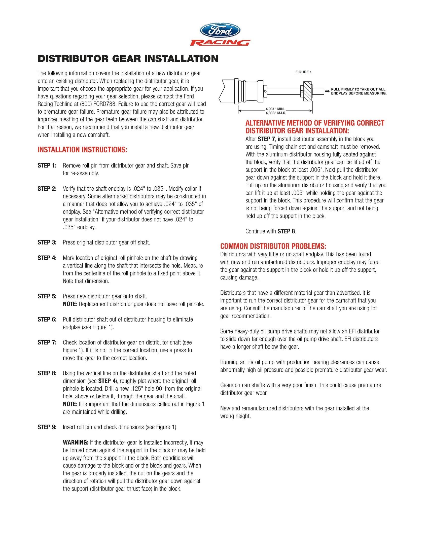

Bottom of distributor gear should not rest on this:
Distance between the base of the distributor and the gear is in Figure 1 of the following:
Regardless the distributor was removed from this engine and it fit fine before and you changed nothing so it should drop right back in with no persuasion. Sometimes it requires dropping the distributor in a tooth or two off and then slowly pulling it up until you can roll the rotor back one tooth and drop it in and repeat this until it is back in the correct position. I have even had to start completely over and put the engine on TDC and drop the distributor in after that.
Some of the aftermarket pump shafts require shortening but its not that common and again it fit before so I am almost sure its an alignment thing.

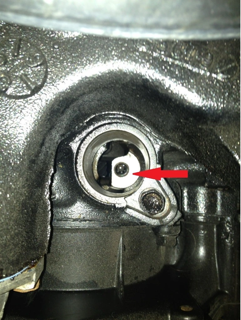

Just for fun, turn it backwards for a minute, then turn it correctly. It would be hard to imagine the screen is plugged, and if the shaft broke, it would fall into the oil pan. It’s such a simple device, it’s hard to imagine what could have happened.
My vote is on a damaged oil pump. Like @AeroCoupe basically said, you don't need to "persuade" the shaft for engagement. I believe that the chances are good that the bottom plate of the pump isn't sealed anymore. You might get lucky if you drain the oil and and use an inspection camera to look through the drain hole, but I think there's a better than average chance you'll want to pull the pan and inspect it closer.
I put the drive shaft tool on the drive shaft by hand and turned clockwise for half a turn and then counter clockwise and I felt resistance. I made several circles and it felt and sounded fine.
Yea, what I was looking for in the pic was evidence of a missing pump shaft, but it appears to be there. And, since the pump didn’t fall into place, but required persuasion. While it felt to you like just a tight fit, I agree with the guys; it’s got to be broken. If you don’t have a camera to inspect it, removing the pan is the only satisfactory way of knowing.
I know it’s a bummer, but we’d be leading you astray to tell you anything else.
