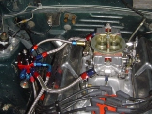

Hello everybody, Wanting to see pics of how the fuel pressure reg. is hooked up. Some people have two. One for fuel and one for nitrous, Well im a newbie with carb engines so pardon the retardiness. I have a 393 built and a nos fogger system is going on.(175 hp) Should I run two regulators? The regulator i just bought has 3 ports with return, So why cant i just run nitrous off the 7-8 psi the fuel running off of (2 ports to carb one port to fuel solenoids) Well any pics or info would be great.

If your going to run a decent size shot of nitrous I would recomend using a seperate fuel system for your nitrous. You can see in the picture of my regulator that I'm using a port to supply my nitrous. But I'm only going to run a 100shot.
