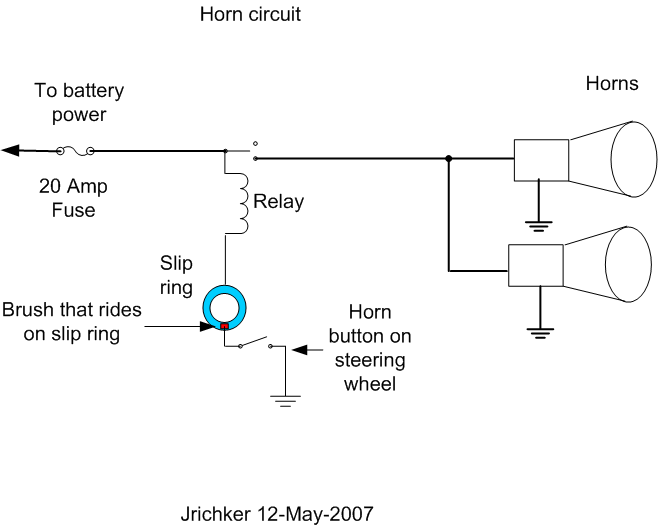

Just in case your problem is that the horns don't work, here are some tips.
The horn circuit has a button that supplies ground, a relay that uses the button to switch the horns on and off, and two horns. The relay reduces the current that the horn button has to carry. This makes it possible to use a small and simple swich and slip ring on the steering wheel.
attachment.php
The horns typically develop an internal short to ground, which causes the fuses to blow. :eek:
The horns are located under the car on the driver's side, forward of the front wheel well. Disconnect BOTH horns, replace the fuse: if the fuse blows immediately, the problem is most likely in the cigar lighter circuit. If not, then press the horn button on the steering wheel: if the fuse blows the problem is in the wiring between the horn relay and the horn. If doesn't blow when you press the horn button, connect ONE of the horns and try again. If it still doesn't blow the fuse, connect the other horn. Chances are that the first horn you re-connect will blow the fuse. Whatever horn blows the fuse at this point has an internal short and is trash. Time for a trip to the junkyard... :crazy:

awsome, yes the horn doesnt work, when the button is pressed i can hear the relay under the dash click, and thats it, if i put the ignition of acc, and push the horn the fuel pump will prime for few seconds and then shut off, but if the car is just being started the fuel pump operates as it should,so the problem isnt the fuel pump. I was wondering where could the horn circuit pass over the fuel pump?
check under the hood to see if there is even a horn..if so put power to the + terminal and ground the case..the oddball wiring was probably the guys fault who did the swap, look at wiring diagrams and get out your glasses!
