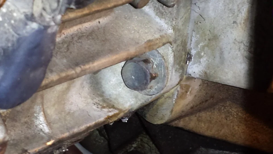

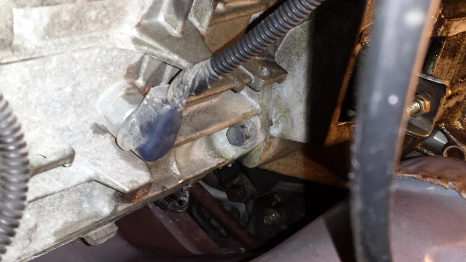

Hoping someone has some advice that will help me out....
Trying to remove the transmission from the bellhousing and was on the last bolt (the top one on the drivers side) and I have started to round the bolt. Using a 15mm socket if you apply too much pressure it just slips and the socket spins. I have used PB blaster and tried to heat it up and nothing is working.... anyone have any advice on how to get this stupid thing out?

Couple of things.
Ger a line wrench in the correct size- they are used for brake and trans lines and grab the bolt on the face not on the corners so it won't round off the ends. That should work but if it doesn't then take a 9/16 impact socket and slap it on with a hammer and then it will come off. You'll just need to get a new bolt.
Be careful not to snap the bolt off in the block or you will then need to easy out the rest of the bolt.
Thanks for the replies guys. I went out and bought a line wrench (same thing as the flare nut wrench right? Looks the same) and those bolt remover sockets also... plan to try the wrench first, then the sockets, and if all else fails I will attempt to remove it with the bell housing and tranny still attached....
Okay, got the thing out. So I guess the magic thing to do in this situation is to... turn the ratchet the right damn direction. That's right, I finally realized I was tightening the bolt instead of loosening it. Sigh. Anyways, using a 15mm 6 pt socket and a swivel and an extension and my jack handle as a breaker bar, it came out. Thanks for everyone's help!
