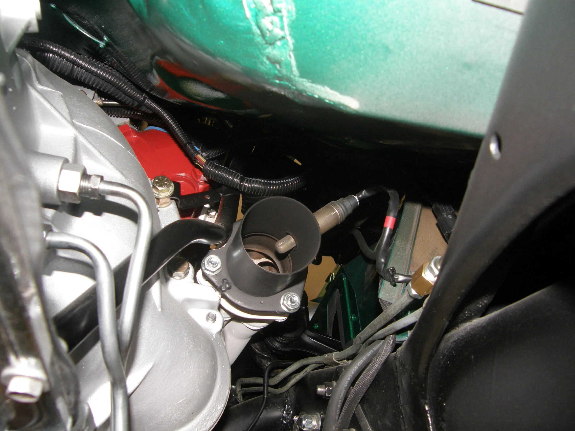

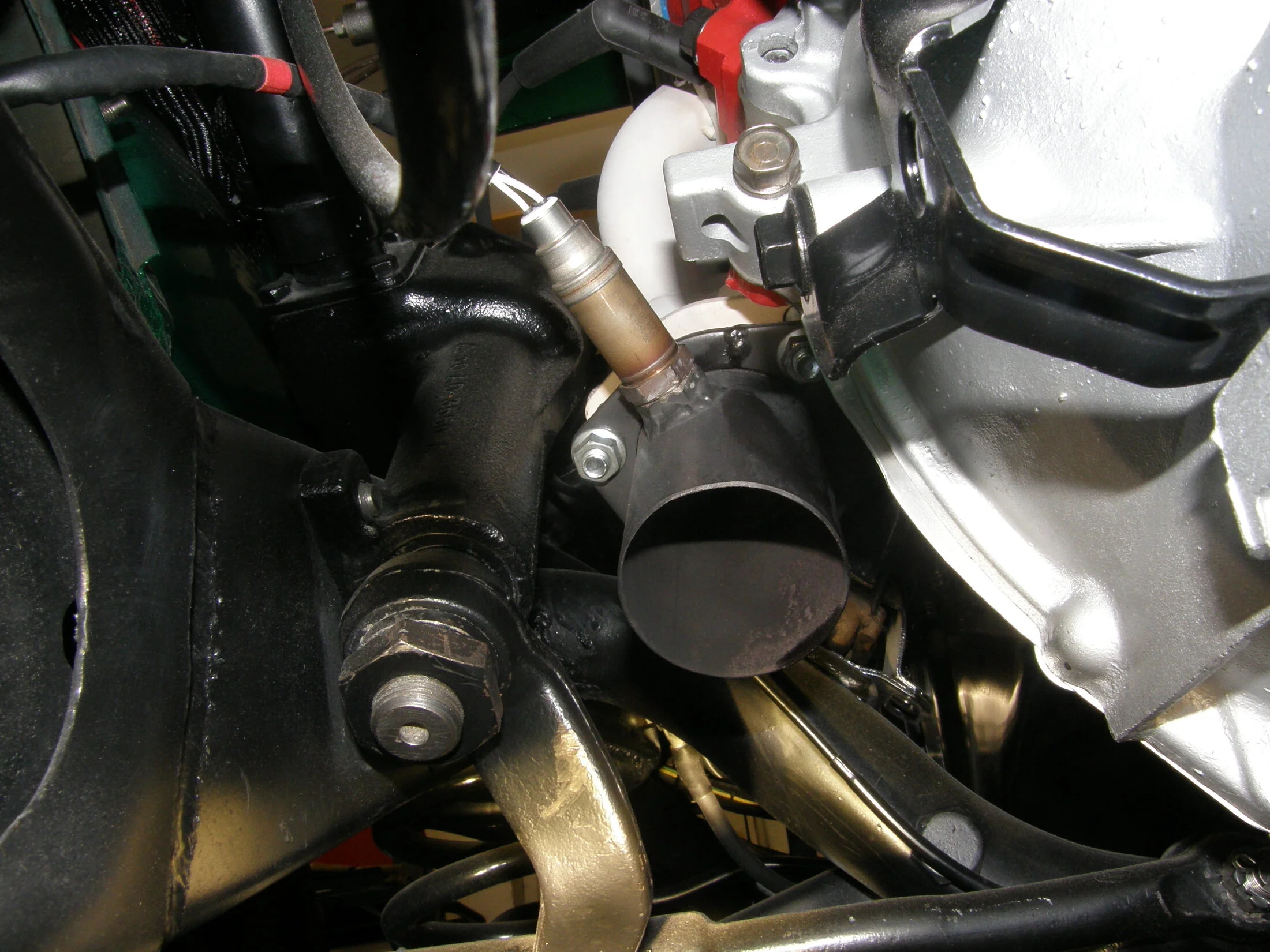

I also wonder about my O2 placement. I'm running Hedman 88400 shorty headers and I placed the O2 sensors in the reducer about 1-1/2" below the end of the header collector. Too close?
From underneath the car left side..................
From underneath the car right side...............

My guess here is with the O2 sensor placement and an open exhaust you are not going to get really good readings. The O2’s on my Coupe are about 8” further down in the X-pipe. However, the ECU is in Open Loop when the engine is cold I.e. when you first start it due to the ECT sensor not being at the minimum temperature to switch to closed loop. The reason this is important is that I open loop the ECU ignores the O2 sensors and delivers fuel based solely on the tables in the ECU. When the motor reaches the minimum temperature the ECU switches to closed loop and uses the O2’s to trim the fuel.

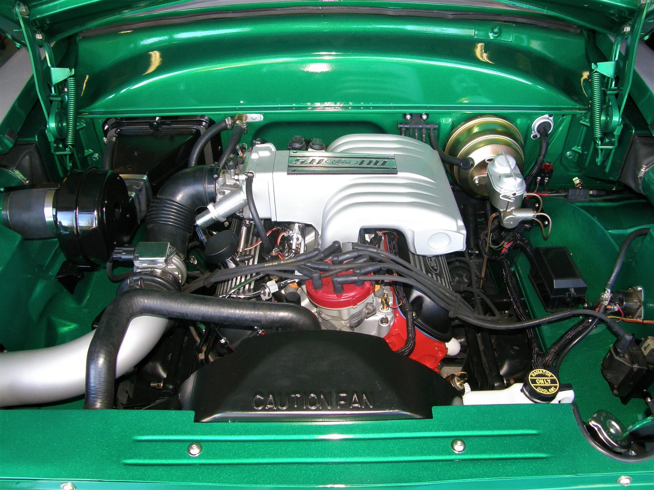

First, the pics show that the engine is not in a 93 mustang chassis, this brings some questions since this is a transplant:

Correct. It's in my '54 Customline. I am using the factory '93 wiring harness. I've checked, cleaned and ohmed out each wire. All grounds are clean and grounded directly to the chassis. I'm a fiend for good grounds! I'm pretty sure there're no vac leaks. All vac hoses are new.

You really need to get the exhaust done through the mufflers and move the O2’s about 8” further down the pipes.

Yes, it has the factory injectors (orange tops) that I assume are 19 lb/hr. When I put the Echlin MAF on there, it was just the electronics box that screws to the top. The housing is original. Are Ford MAFs still available new and if so, where could I purchase one? You can see the MAF in the pic.....

Also, do you really think moving the O2's 8"further down the pipe will be helpful? I can plug the bungs that are in the reducer and have the exhaust shop that fabs my exhaust system install bungs in the new pipes for me.

Not to argue with AeroCoupe but I have my O2 sensors in the same place as you and mine is fine. I would agree that you need to add some exhaust pipe after the collector say 18-24" to get the O2 sensors to readings right. My old iron manifolds had the O2 sensors between the last port and the flange so I think having the sensors in the collector is OK.
Just going off of what my tuner told me. He showed me what the signals look like and further down you get in more laminar exhaust flow which allows them to read better. Not saying you cannot put them in the collector but there is a reason Ford put them further down.
