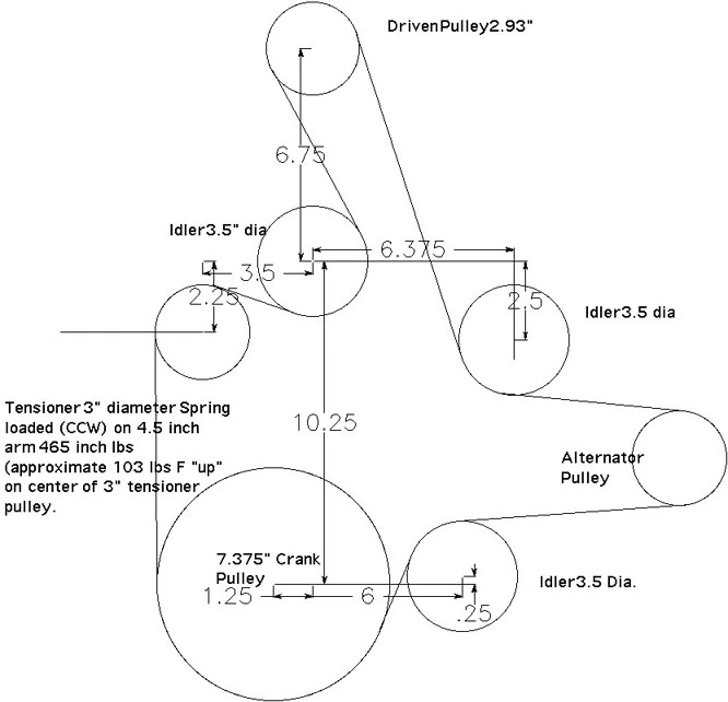

I have a 1999 cobra with a procharger, this weekened the belt broke. I bought a new belt but I can figure out the routing of the belt. Anybody have any info that could help me

i googled this if it helps. I think it said 03-04 but its probly the same or close.
Goto Procharger's website and DL the instructions. They should have a diagram of how the belt is routed.

I got the new belt on and now it jumped a rib and no more 6-rib belt just a 5. Everything lookes good with the pullies, what the hell?
