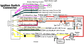

Wiring Diagrams:…
Sorry, the AutoZone wiring diagram links no longer work. You can navigate to the diagrams yourself via AutoZone.com | Repair Info and select the car year, make, model and engine. That will enable you to bring up the wiring diagram for your particular car.
See the following website for some help from Tmoss (diagram designer) & Stang&2Birds (website host) for help on 88-95 wiring Mustang FAQ - Engine Information Everyone should bookmark this site.
Ignition switch wiring

4.) Then pull the small push on connector (small red/blue wire) off the starter solenoid (Looks like it is stuck on a screw). Then jump between the screw and the terminal that is connected to the battery. If it cranks, the relay is good and your problem is in the rest of the circuit.
5.) Remember to check the ignition switch, neutral safety switch on auto trans and the clutch safety switch on manual trans cars. If they are good, then you have wiring problems.
Typical start circuit...
