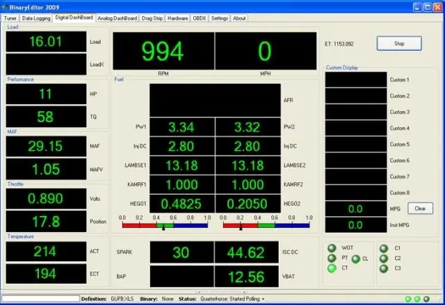

This is right after a cylinder balance test is done and looks to me like HEGO1 is running good and HEGO2 is running lean. During the test HEGO1 was running rich and HEGO2 was in the green:

I checked my datalog and the Hego readings bounce from high to low when the engine is fully warmed and during part throttle. System code 42 is given during a KOER test. The engine runs well when it's cold, but rough/hesitant/bogging when it is warmed up. I assume this is from the 42 running rich.
1.) Check the O2 sensor ground. It is the orange wire in the engine injector harness that comes out near the TPS wiring. Ground it ot the cylinder head or intake manifold.
2.) The 42 code can be due to a misfire condition, which means you get to chase the spark plugs, plug wires, PIP, TFI and ignition coil as being possible causes. If you do not see or feel evidence of a miss as the engine runs, this may not be a productive path to take.

Hey I'm going through your surging idle checklist and checking my datalog with Livelink 5.1.0 (awesome that you can take the CSV and see things visually), and I notice my VBAT is less than 13 @ 1000rpms, no higher than 13 either, and MAF Volts are 1.154 ; and I will be testing the MAF as described in your instructions.
My questions are:
1) Could the MAF high voltage cause a rich condition? (I try and understand how things work...)
2) Does the low battery voltage cause incorrect sensor readings? I have a 60amp alternator, just need to research hooking up the 3G that I have.

MAF operational theory:
Changes in RPM causes the airflow to increase or decease, changing the voltage output.
The increase of air across the MAF sensor element causes it to cool, allowing more voltage to pass and telling the computer to increase the fuel flow. A decrease in airflow causes the MAF sensor element to get warmer, decreasing the voltage and reducing the fuel flow. Generally speaking, higher MAF output voltage means more fuel delivered.
Measure the MAF output at pins C & D on the MAF connector (dark blue/orange and tan/light blue) or at pins 50 & 9 on the computer. Be sure to measure the sensor output by measuring across the pins and not between the pins and ground.
You need 13.8-14.2 volts to keep the battery charged and the electrical system working smoothly.
All the computer sensors run on the 5 volts from the computer's internal power regulator. As long as you have 9 volts or more, the computer sensors will not be affected by variations in the car's electrical system.
