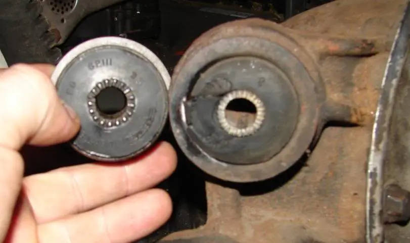

Is there a difference between the 96-98 Cobra UCA's/axle bushings and the FRPP ones?
I was checking out the bushings from my cobra when I did a rear swap and noticed the (axle end) FRPP, cobra, and my 98 bushings felt all the same so I can't really tell the difference from that. Only noticeable difference was each inside bolt rods had their own style teeth from each axle bushing
FRPP left, Cobra Axle on the right

never sure what Frpp packages and there have been some mix-ups wth them. I can tell you there are 2 different part #'s for the rear upper bushings, 2001 up and 2000 back. I can't make-out any #'s form you pics, do you see any #'s on the bushings?

Well the bushings on the cobra are wore out on the sides so the only thing that is readable is SILENT (for SILENTTBLOC) left side bushing has a 1 on it, the right has a 12. Doubt the 1 and 12 mean anything, could just be the what casting mold it was in, but the FRPP one is 35. And a very faded 'lll'
There's nothing left on the gt bushings though
