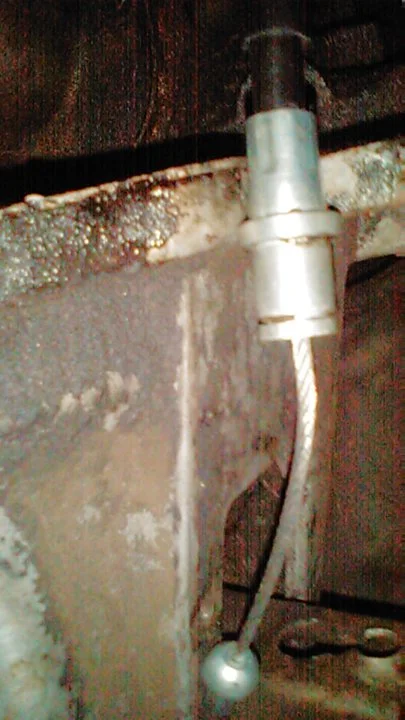

Hi. I'll try to keep it short but this may be important info. 83 gt has sat for the last 11 or 12 years, I finally got around to pulling the engine to do some work to it a few months back. Now I'm in full effort to get it on the road since I have nothing. Have done as minimal as needed to get it on the road the best I can. Only thing keeping it from driving is water pump and thermostat and clutch cable... The clutch cable was fine until putting the motor back in the car (transmission was left in the car) I didn't see or hear how but the. clutch cable got bumped off the shift fork during putting the motor back in. I put the cable back on and it slipped horribly

I can't see any evidence of damage to the shift fork or the pedal. I've never messed with a clutch cable before so I assumed it was broken. I bought a new cheap cable and put it in. The outer sleeve is to short on the cable by like 3/4 inch. The cable reaches if I go around the bell housing but that obviously won't work to drive it. The new cable slips less but to bad to drive it. I still have the original (assuming what Ford put in it in 83. Only 140k miles on car) which is shorter then the new one in total length. Any ideas how to getone of those to reach? The original worked great before iI pulled the motor. I just see no damage anywhere to prevent it from being operational

The outer sleeve is 3/4 inch to long. To where the inner cable won't reach the fork

It That is alote of info. I'm on my 3rd time reading it. As far as I can tell neither the new or the original are adjustable. What gets me is the original worked perfect before it popped off. It's a stage 2 clutch and never a problem. I can't say there is any binding since the pedal feels right. I'm not driving it except for test rides type trips so I don't burn up the clutch in the process. Aside from it not disengaging all the way leading to some major slipping

Sorry I'm still getting used to this forum and my phone isn't getting along with this site that great.. Before the original cable popped off and prior to the motor pulled out the clutch operated perfectly leaving traction the problem. If I put the original back on it is worse then the new cheap one. As you can tell in the picture I don't have nuts at the fork for adjustment. It just pops into the hole in the fork

Aside from the slipping it drives nice. Just need that extra 3/4 inch or so. The width of the bell housing to get it where it needs to be. A little more would be great but not needed. I like your idea of having that extra inch. Don't need it though

I did call ATP(brand of cheap cable I bought) and they said it's not adjustable and it may be a defective part. I'm taking tonite off but I plan to swap back to the original tomorrow. I read in the chilton's about the self adjusting part and quick instructions how (lift pedal all the way up then pushing down all the way) I didn't try that before getting the new cable. Since I didn't know about that. I plan to try that tomorrow. With the original cable.

I just don't see why a cable that looks good and not broken like I thought that had worked on the car for years and years all the sudden had became too short

@83-gt-hatch
I guess that you don't understand that there is a self-adjusting mechanism for the clutch cable. As the clutch wears the cable tension changes, that is why there is a self-adjusting mechanism built into the clutch pedal. There is a toothed plastic quadrant with a ratchet pawl that engages the quadrant ratchet teeth. As you pull up on the clutch pedal, it ratchets and takes any slack out of the clutch cable. Mess around with the pedal or even bump it while the end that fits in the clutch fork is loose, and it tries to take up the slack in the cable. That has the effect of shortening the cable.
You can use a screwdriver to lift the ratchet pawl off the quadrant teeth. That will allow you to move the quadrant to allow more slack in the cable. If the cable is too loose, pull up on the pedal. The ratchet pawl will allow the quadrant to take up the slack in the cable and lock the adjustment.
Adjustable cables are used when the plastic quadrant is replaced with an aftermarket metal quadrant. The downside to this setup is that you have to get under the car to adjust the clutch. Add a firewall adjuster to an adjustable cable setup and you can spare yourself from getting back under the car to make any fine adjustment that you desire.
The fancy 2 and 3 hook aftermarket metal quadrants are for use with stock length cable and a firewall adjuster. Use the firewall adjuster and screw in and out to take the slack out of the cable and get the clutch engagement point just where you want it.

Above the gas pedal behind the dash (where the clutch cable enters the car) there is a whitish yellow plastic cable adjuster. When the cable slipped the adjuster adjusted all the way out... That's why the cable seems short.

/401dfb0ca245cb9e0c1e9ad549785f48.jpg[/IMG]
What I do is tie a string to the hook part of the quadrant below the spring on the pivot point. I then take a screw driver and release the triangular locking mechanism. Pull on the string tied to the hook part and tie it to the steering wheel. That way it'll hold the position so you can attach the cable to the clutch fork. Once in the clutch fork untie string and bam done. The best advice I can give is to buy an aluminum quadrant with a firewall adjuster..... The factory plastic ones usually end up breaking when you least expect it. Your cables are fine...

Thank you for your advice. I know what I have to do now. I didn't understand how the self adjuster worked. In the past with my old 85 ranger I learned all about a hydraulic clutch system. I didn't understand what all you wrote yesterday completely. The latter is explained to a easier understanding. When I put the motor back in and whatever bumped the cable off must have upset the quadrant pawl

Now the fun part of getting above the pedals and loosen it back to where it's too loose to get it right. I'm still going to put the original cable back on and do what you two told me and loosen it at the quadrent pawl and go from there. I'm crawling under now. I will update you soon and let you know how it goes. Appreciate the help

Thank you very much for your help. Works like new again. It took a little time to find and get it to move. 10 times with the pedal tightening it up and works like a charm. Just got back from a test drive. It appears my overheating problem is from the vac advance hose. Messing everything up. I think after I tinker with that it's good to start driving it again. It's been since December 2003 since it's been driven. Aside from my 5 test runs leading to 11 miles before tonite. Thank you again. I hope one day I get the chance to lend you a hand (although it appears I am amateur compared to most of what I've seen in these forums)
