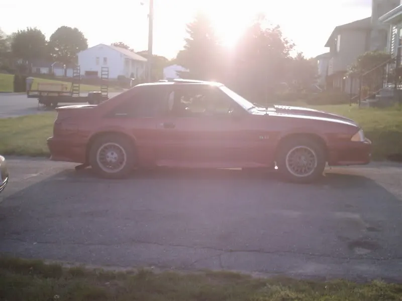

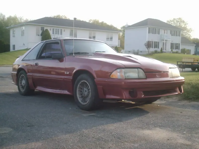

Hey guys, I registered here a while ago when I got my first mustang. But after I found the car was rotted to all hell, I sold it and havent gotten back into one until now. 1990 GT
Bought it on thursday. for a grand. Crank no start. Got it running today. There was a broken wire going to the ECM relay which meant the ecm would not poer on at all, hence my no fuel/spark problem. Repaired the break, put some gas in and it fired right up. Ran pretty well seeing how I havent timed it properly yet. Thats for tommorow.
It does have a clutch issue though, wont disengage... only when the motor is running though. Works fine when the cars off. Throw out bearing is whining,and you can hear a faint scraping noise when the clutch pedal is down. so a clutch kit will be ordered soon.
I did manage to take her down the road however, when its in gear it drives beautiful. cant wait till its timed tommorow.
It does need work as you wouldexpect a thousand dollar fox body would, but overall im pleased. Rust is minimal, engine runs strong and trans feels good when you can actually get it in gear.

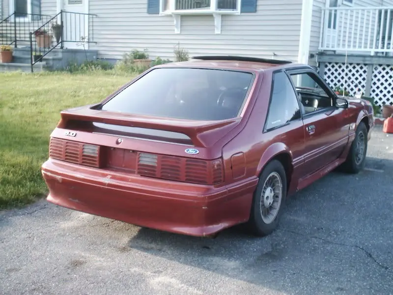

darn the sagging side skirts!....mine does that....barely...but its noticable......looks like a nice project though....and sounds like your layout of the plans is cool

sidesteps arent the only thing sagging, check out the exhaust. The previous owner decided it would be much easier to run straight pipes under the axle than go through the trouble of bending the pipe up and over.
