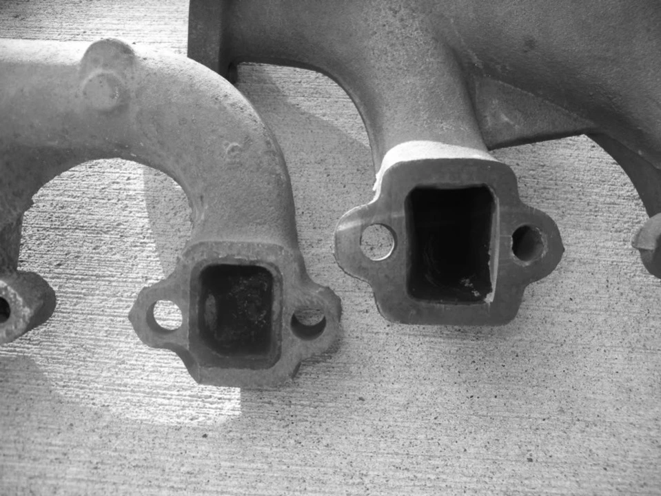

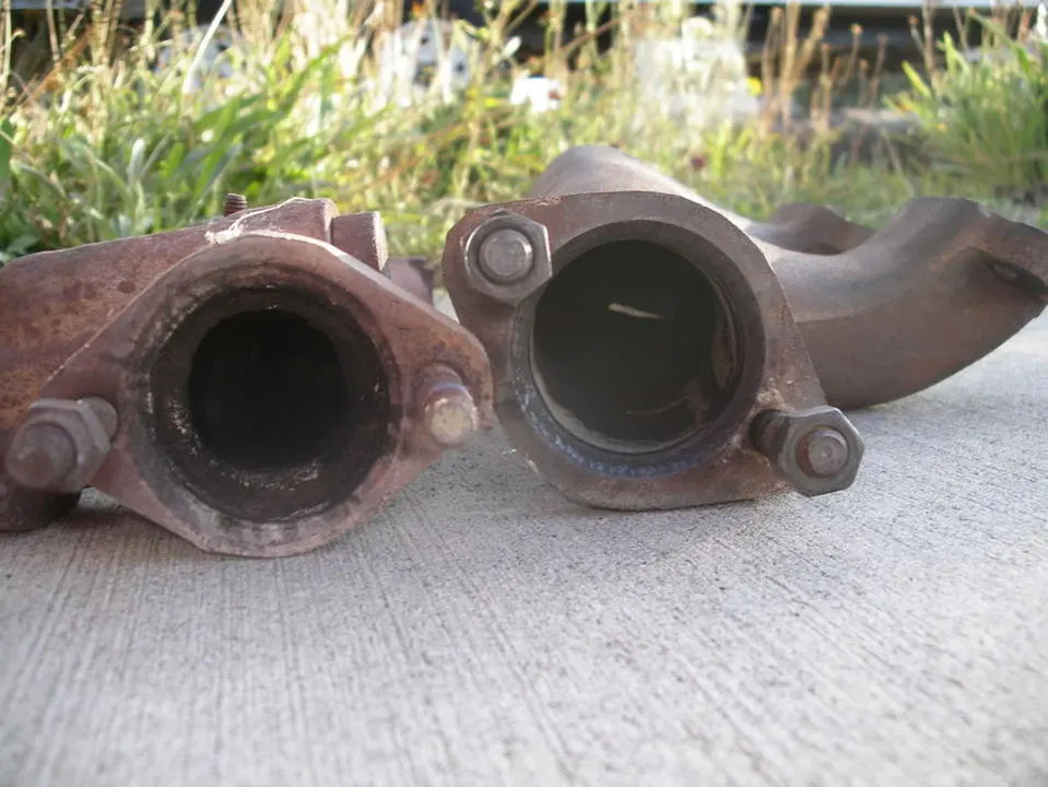

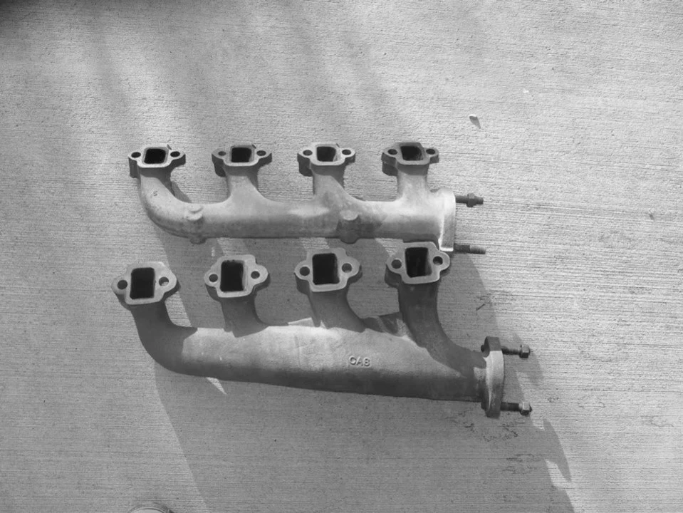

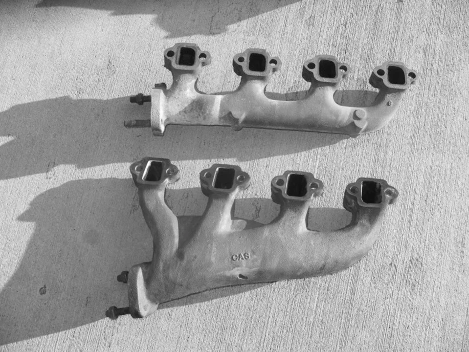

I use Remflex gaskets (which I would recommend) and have ported out the primaries and some of the collector. The Hi-Po manifolds fit well, but the ports needed work and the collector was too small for my tastes as cast. My bolt holes lined up well, but some of the recent castings have had issues with the manifold to head bolt holes not being well aligned. The fix for that is a little dremel work to enlarge the bolt hole if and where needed. Here a few pictures comparing my Hi-Po manifolds to my original 1966 stock log-style California smog manifolds with the indents to clear the air tubes (thermactor fittings). Note the differences in shape and port sizes between stock log-style and Hi-Po and also differences in the diameter of the collector to H-pipe. You can port it out to ~2 1/4", maybe a little more, for better flow yet. Sorry for the size of the pics--I wanted to show details not available in thumbnail sizes. ;)
Collector size difference
Port size difference after a little porting on the Hi-Po. The Hi-Pos started out bigger, but porting will help with the port shape. The carbon deposits in the stock manifold on the left is the size of the Edelbrock exhaust port. YES, I had a leak at the corner, but these were only used to break in the engine.
Passenger side
Driver side

Thanks for the comparision pictures.
That is really intersting to see them side by side like that.

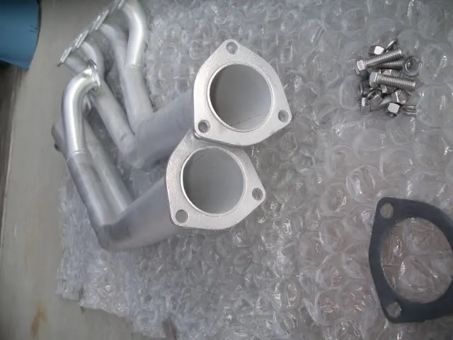

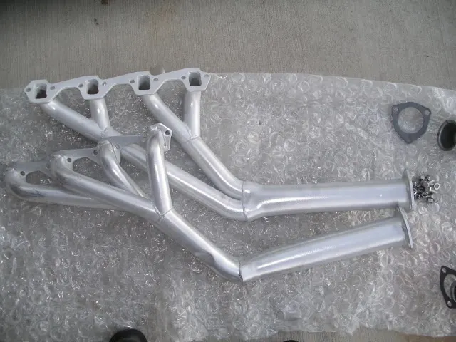

Here are some pictures of Jet-hot coated reproduction tri-y headers for illustrating the stacked passenger and side-by-side driver's side collectors. The dent is to clear the steering box. These headers didn't work with cable clutches.

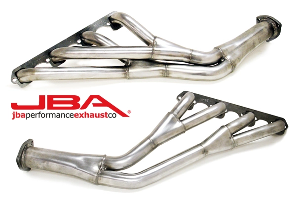

Here is a picture of JBA SBF tri-ys that have the 5/7 collector tuck in and under the 6/8 collector and y's vertically. Even then, JBA says only for z-bar linkage or auto mustangs.

If you look at my pictures above, you'll see the collectors were enlarged enough to fit a 2 1/4" exhaust. That's about the largest you can go with these, though. Depending on heads, intake and cam, 2 1/4" dual exhausts should flow plenty to meet the ~300HP goal. :D

Well I'll be, so it is. That's a slick and subtle upgrade. The tricky part would be an H-pipe. Motive makes a 289HP H-pipe in 2.25", but necks it down to 2" at the flange. I'm sure they could be persuaded to make one with 2.25" flanges, it would actually be less work for them. Did you machine the outlets yourself?
