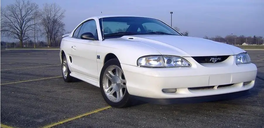

Got my 8000k's from stangmods in this weekend.

little more info...
I bought my kit in October of last year for ~$390 shipped. That was for 2 ballast with covers, 2 projectors, and the 4100k lightbulbs. Now i had to make my own wiring harness for them. Luckly HIDplanet has a geek savy forum with plenty of how-to's. My harness cost me less then $20 at radioshack and i had to buy all the electrical stuff, you may have it already.
Now before, I already had these headlights as i was trying to get better output. I found out these lights suck to no end. No biggy as I got them for ~$120. I decided that I was a step ahead of everyone in that i had a great base to start on my retrofit. I chopped these up and fitted the new good projectors into them. I used high temp gasket sealer of all things, holding up great so far.
(whoring the car, i know:rolleyes: )
