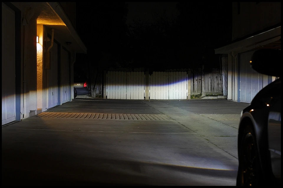

Plus the whole point of HID's is the nice cutoff line.
GOOD HiD setup (this is actually an HID retrofit using HID projectors mounted inside a halogen reflector housing)
BAD HID retrofit kit (HID kit slapped in a halogen housing)

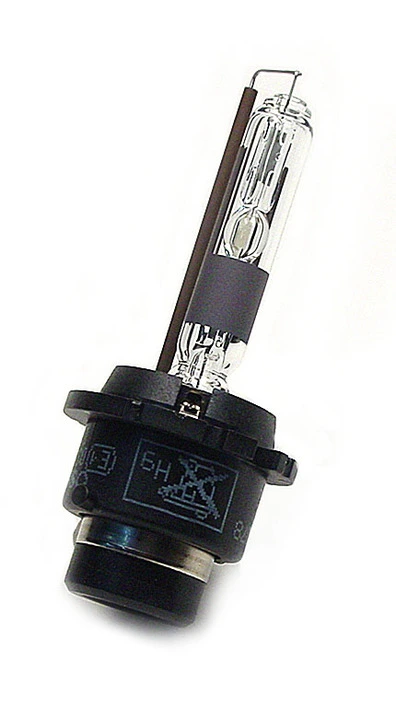

fiveohwblow said:
What about the vehicles that come factory that way? I agree that projectors are the "best" but dont Toyota Prius' come with HID's and no projector?
My G35 comes with a reflector style HID setup and it still has a nice cutoff although not as sharp. When i drive, you can barely see any light above bumper height.
Infiniti actually has a completely different headlight for the early versions which used halogen headlights. So both the halogen and HID were reflector setups, but they are designed differently. Side by side, you can see a difference.
Reflector HID's use a different bulb called a D2R which is actually painted over some of the bulb. It cuts down on the actual light output by painting the bulb in the areas that cause glare.
Most HID retrofits sold do not paint the bulbs like the D2R. They use rebased D2S bulbs which are projector-only bulbs and stick them in reflector housings.
Some good info on this page too
Automotive lighting FAQ - Headlamp HID bulbs
"The main difference is the U-shaped masking on the D2R that blocks out unpredictable light in certain directions. Also, the base has different notches. Name of base is P32-d2 for D2S and P32-d3 for D2R. D2R was developed so that Mercedes could still use their reflector based headlights in the mid 1990s. They did not want use projectors like BMW. A glare box inside the headlight could have been used to accomplish a straight line, but a mask painted on the bulb was cheaper to make and had better precision. Other (near) luxury cars (Lexus, Infinity and Acura) followed Mercedes and equipped their cars with D2R bulbs in reflector based headlamps. Using a D2R in anything else than a OEM HID headlight designed for the D2R bulb makes no sense. It will only reduce output. Some HID kits comes with D2R bulbs. Some amateur kit designers will even claim that D2R genrally reduces glare in a retrofit. This is nonsense. The D2R bulb masking is around 3-4 a'clock and 8-9 o'clock when bulb is in right position. Those are not the (only) sectors that creates glare. "
