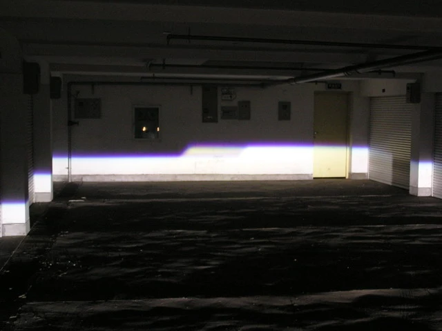

To answer the question, you really shouldn't go with HIDs in the factory housings at all. Reflector housings do not have the pattern control that, say, projector housings have and you end up blinding drivers in on-coming cars. This is the reason you never see HIDs offered from the factory in reflector housings. Here's how a decent projector cuts off the beam:

Go 4300K, 5000K or, at most, 6000K in a decent projector housing or don't do HIDs at all.
