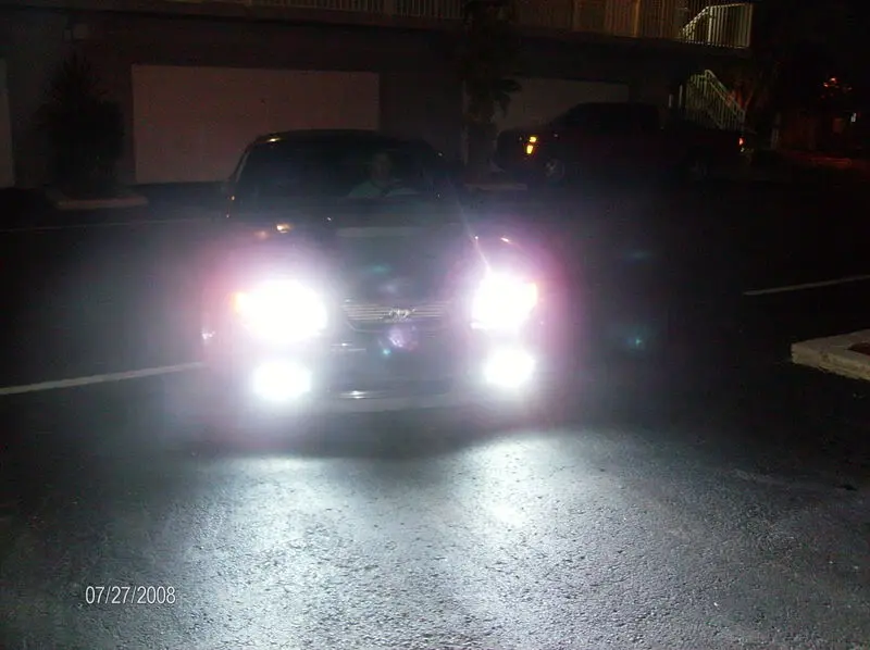

Thanks. I was switching the right wires but the problem was that my battery was so low from playing music while I cleaned it earlier that it couldn't power the HID's. That's how things go with me and my projects.
Here's some pics. Sorry about the flash on the camera not being off.
03GtinFLA ^^ looks good man. Glad you got everything figured out. What color bulbs did you end up going with?
Ohh, and on a side note I have heard that you should always make sure that your car is running when you have your HID's on because you could potentially harm your ballast if your battery does not have enough power to pull them by itself.
Yeah it took me all day before I figured out what my issue was with the headlights and then the fogs probably took about an hour to hook up. Thanks for the heads up about the lights. I really like these lights. THey are much much much better than the stockers. Oh and I ordered the 8000K. I was worried that they would be too blue but they are perfect. Just a slight tint of blue. Very slight tint.
