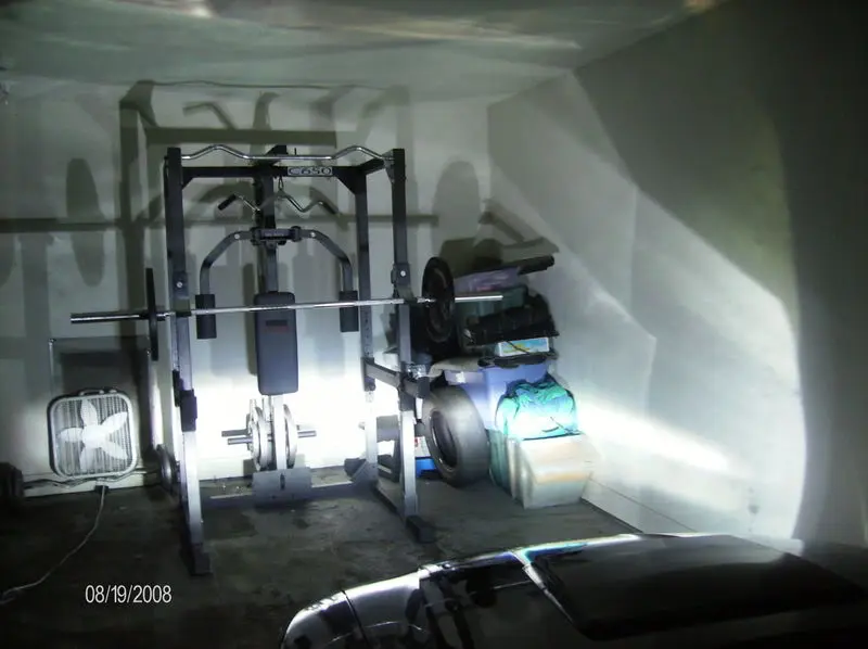

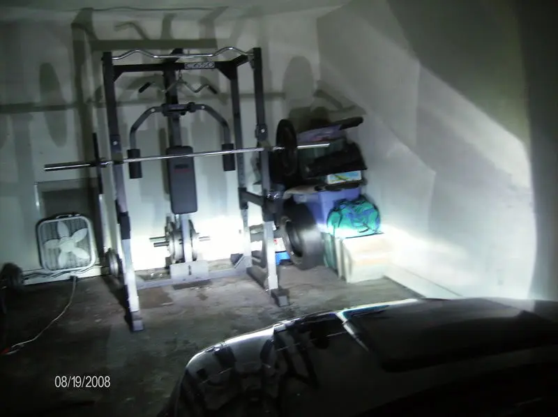

Fogs only................
Fogs on garage wall........Sorry it was late and didn't want to wake the neighbors by driving outside and taking pics against my garage door.

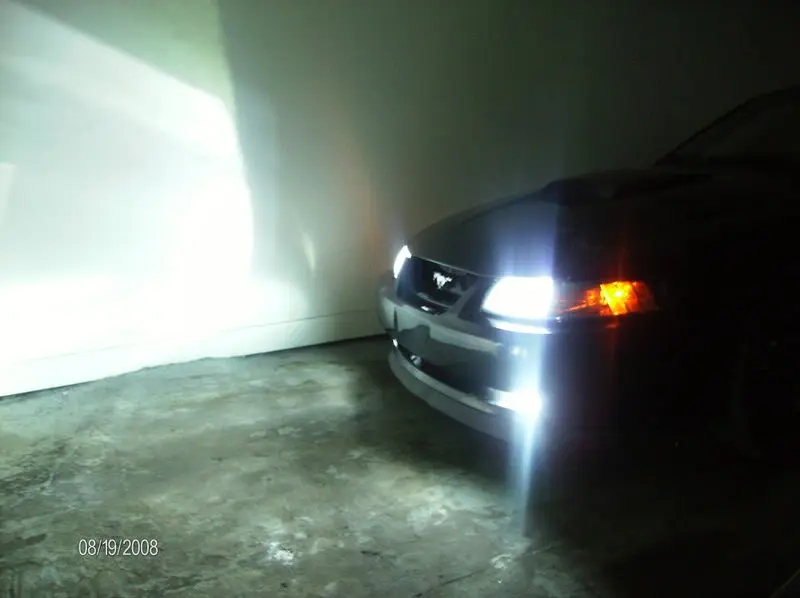

Headlights and fogs...........

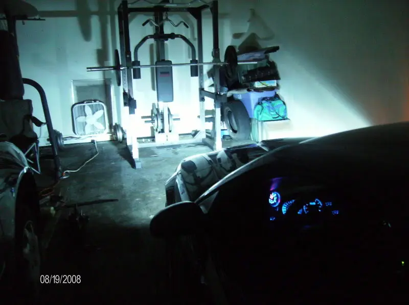

Low Beams...........

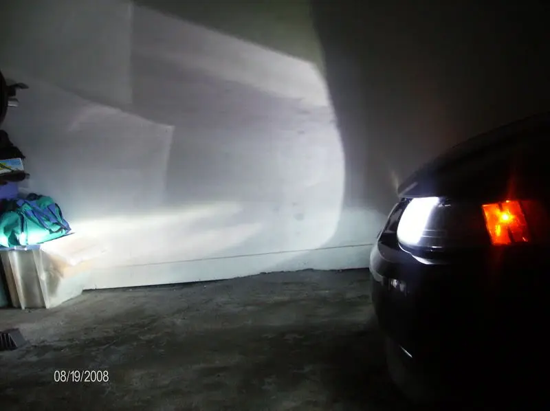

High Beams...........
And my cars high beams.............
Like I said, they glare. It's obvious by looking at the sideshots against the wall. There isn't much noticeable difference between the highs and lows in that picture but it is more noticeable on the road. Basically, you get what you pay for. I'm good with that. :nice:
