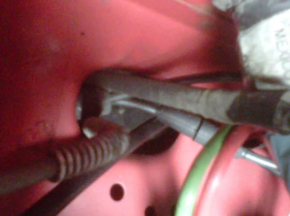

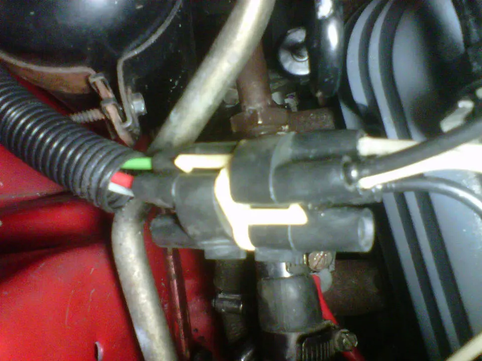

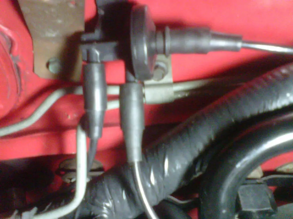

where do these vacuum lines go to? passenger fender access hole shown.
this seems to be pulling vacuum correctly...
only the larger hole in the plug has constant vacuum, is this correct?

reason for the above post is i don't believe the egr is getting vacuum nor any of the smog valves. i realize code 94 and 44 could explain the smog but i get no egr code and have yet to see the egr diaphragm move properly with the engine running. in fact the egr diaphragm appears to be sucking toward the intake and is slightly popping out hte relief slots in its housing with the engine running. you can feel some sort of air movement on the egr vacuum tube but it is not strong or constant, more like a flutter.
