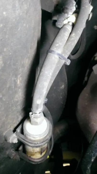

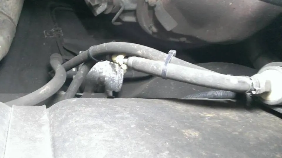

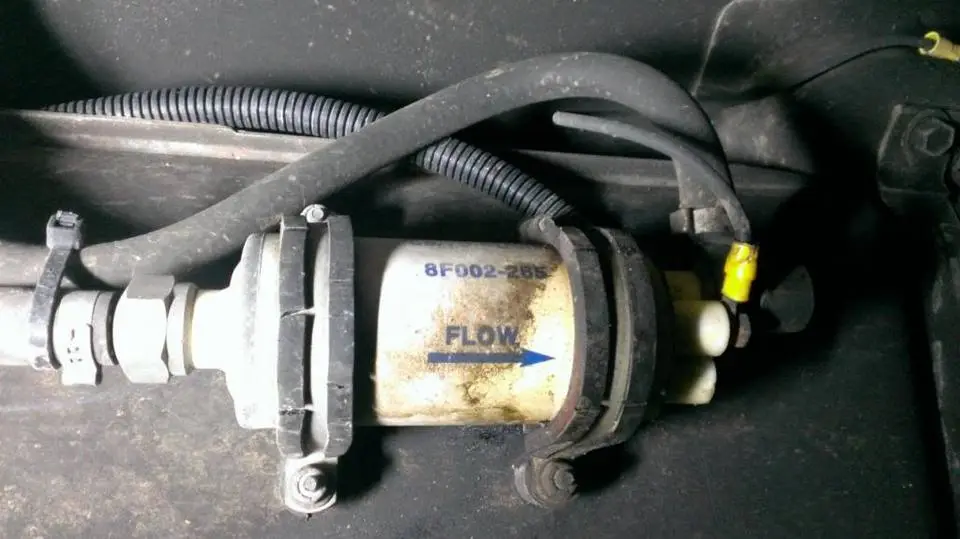

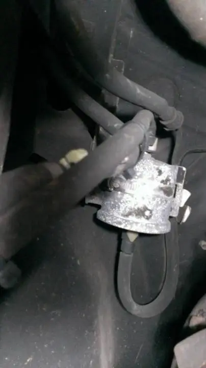

So I got under the car. I will include a few pics. It appears the new fuel pump is before the fuel filter. So the high pressure fuel pump has to pump through the filter before it gets to the engine.
Here are pics. They aren't great, not much room, when I finish my water pump I will be able to jack it up and get a better look.
