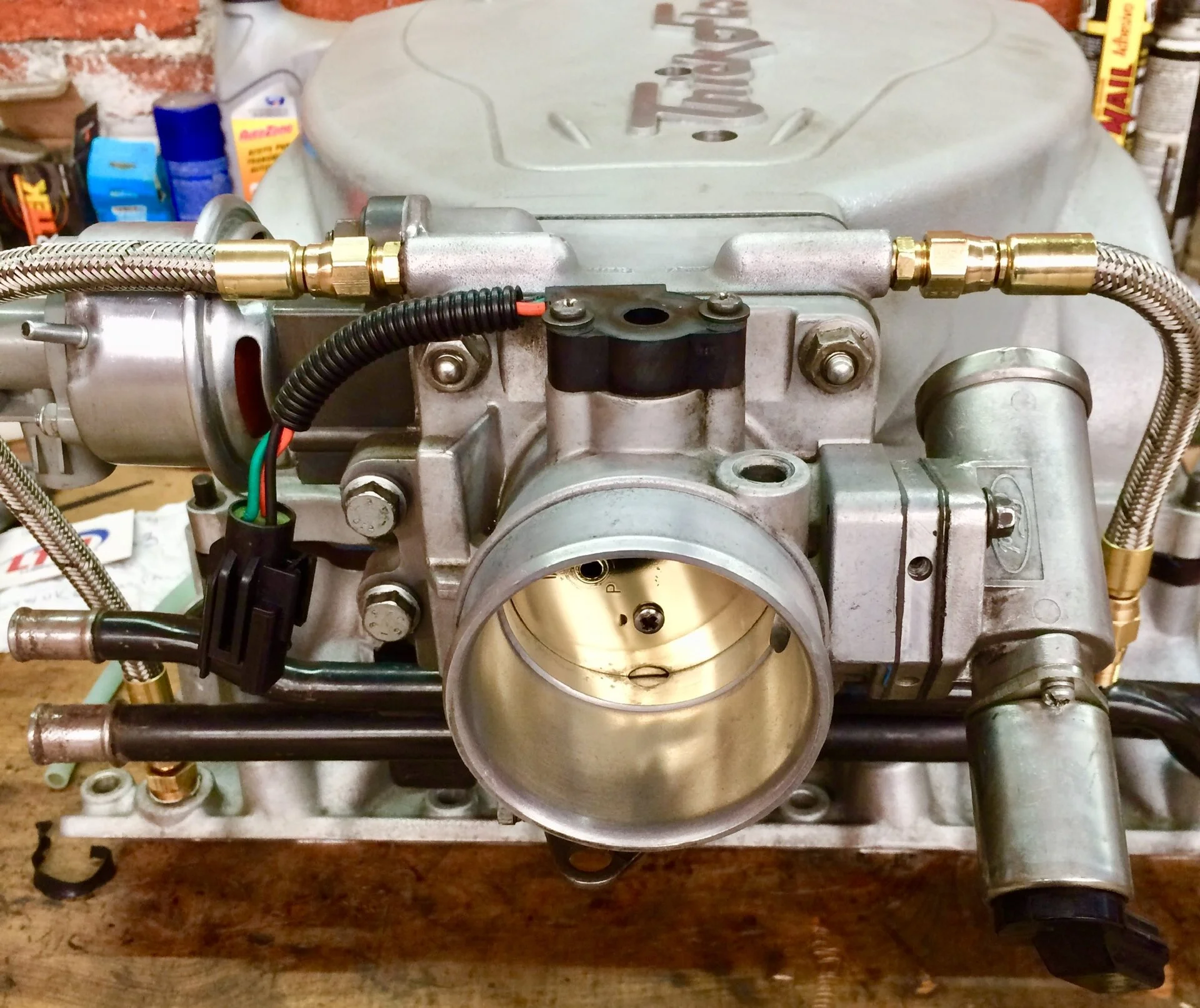

The hole in the throttle blade may have something to do with the problem you are having, I read the modification to the blade and what you did to make it smaller ( if I read that post correct) but there is not supposed to be a hole there.

The hole in the throttle blade may have something to do with the problem you are having, I read the modification to the blade and what you did to make it smaller ( if I read that post correct) but there is not supposed to be a hole there. Actually I think it is bigger than 1/8” :O
Thank you for your reply,
I appreciate your help and if that’s the case then I will just cover that opening and leave just the opening around the TB plate set by the adjusting bolt. Actually I thought the was 1/8”, but actually I think it is bigger than that as seeing on the pic. That could be the problem, we’ll see...
Thank you all again for the patience

As an update I plugged the hole on the TB blade which I’m very sure was there before.
I will set the throttle base idle speed using a 0.010” feeler gauge until the stop screw touches it and then give one and a half turns, set the TPS to 0.98 Volts. I will use the modified IAC valve (Gaskets in between the solenoid and valve body No free flow thru the valve ports when the valve is unplugged), and timing spout disconnected.
I will set the idle when the engine is at OT. In case the engine cannot run that base idle 625-650 then I will open more air by using an aluminum bypass spacer with two set screws installed in between the TB and the IAC valve. Reconnect everything and take it out for a test.
I will post the results from this test and decide if I will just keep using the IAC restriction plate with a smaller hole.
Good luck to me
