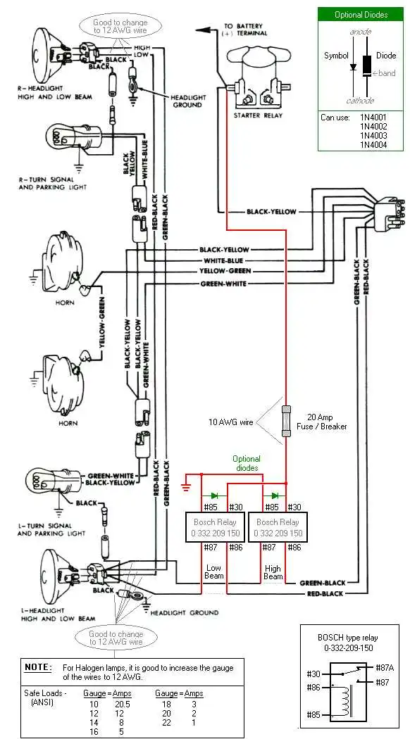

Didn't price the Summit kit, but this might be cheaper.
