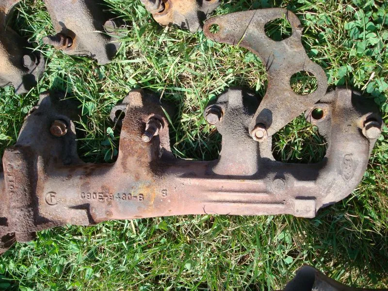

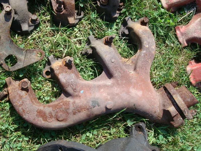

The strange bend I pointed out on the 351 manifold extends the bottom end farther down. HP manifolds would exit higher, creating clearance problems. With an auto trans, this would not be a big deal. If you switch from the headers to the manifolds, you'll notice a power loss between 4500 and 6000 rpm. Now you have to ask yourself, how much time do you actually spend in this power range?

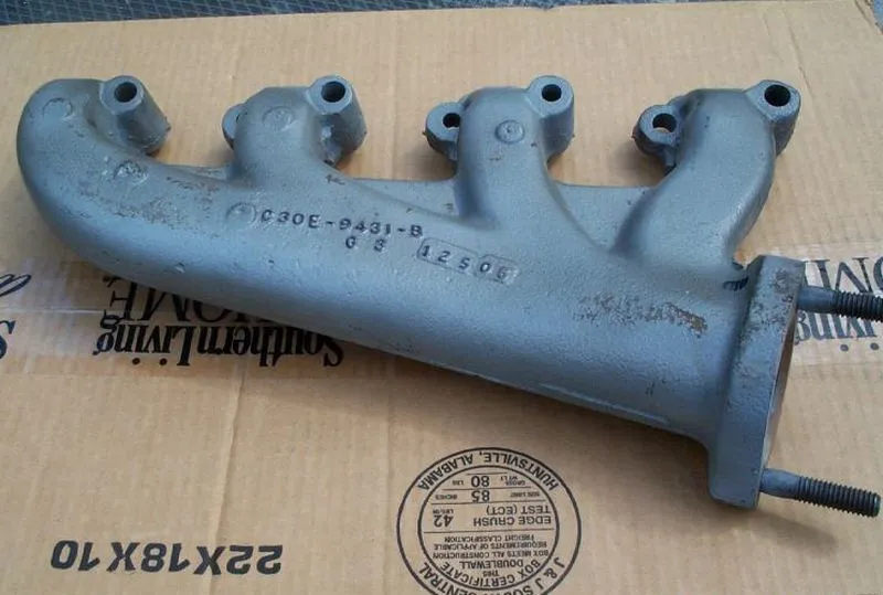

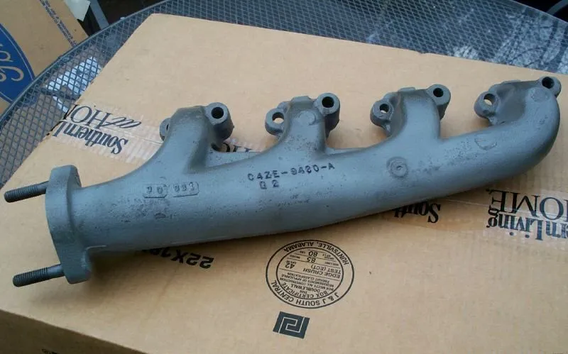

If you ever had them side-by-side, you'd see the 351W manifolds are basically altered HP manifolds. The odd outlet on the LH side is due to the increased height of the engine (to clear the clutch equalizer), and the RH angles down a bit more. I'd stick with 351W manifolds on a 351W, and HP manifolds on a 289/302.
