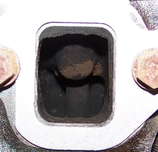

Getting back to the exhaust, this is a stock 67 exhaust port. There is a huge but typical amount of excess metal around the opening blocking good flow (marked by shading), and this particular head has the internal smog bump, placed where a Chevrolet spy might have put it to kill performance. Both must be removed for performance. If you don't, you could use long tube heaters and 3" exhaust and your power will still suck.
