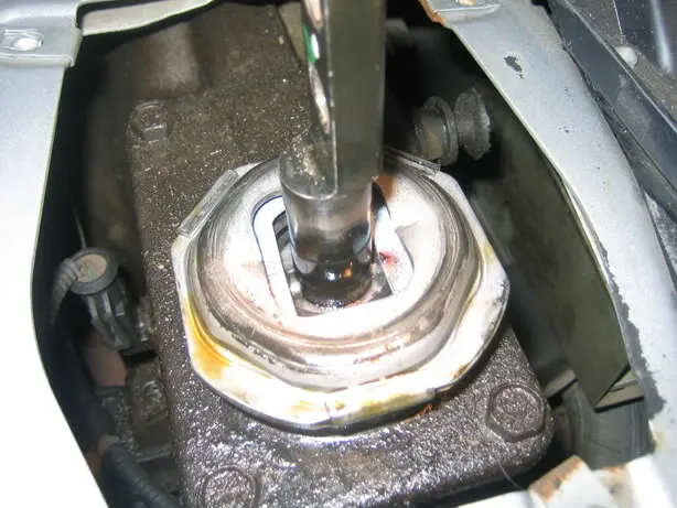

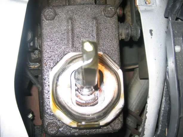

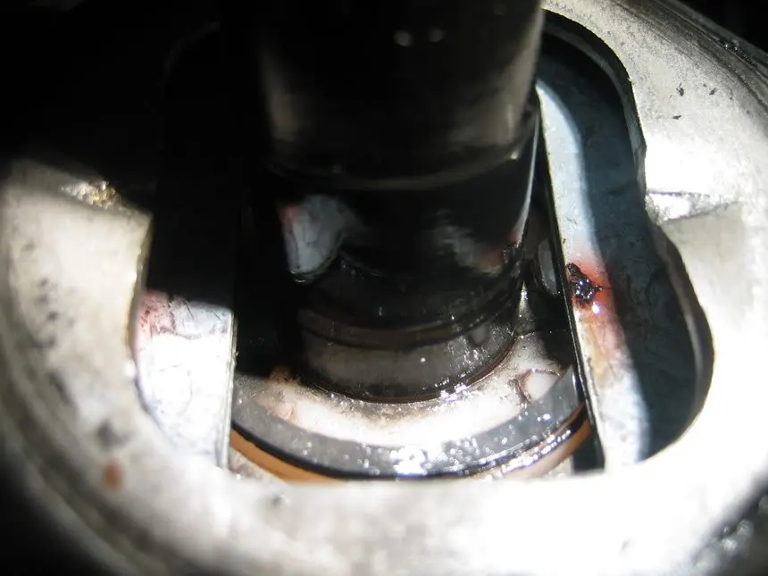

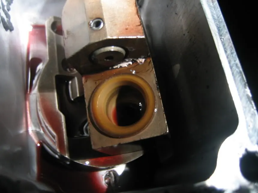

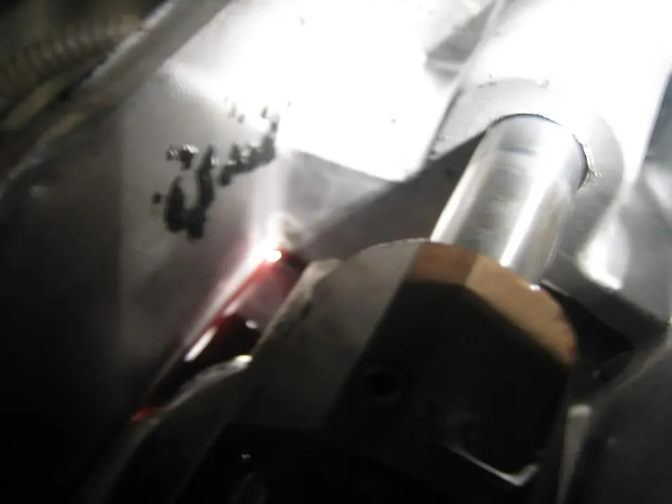

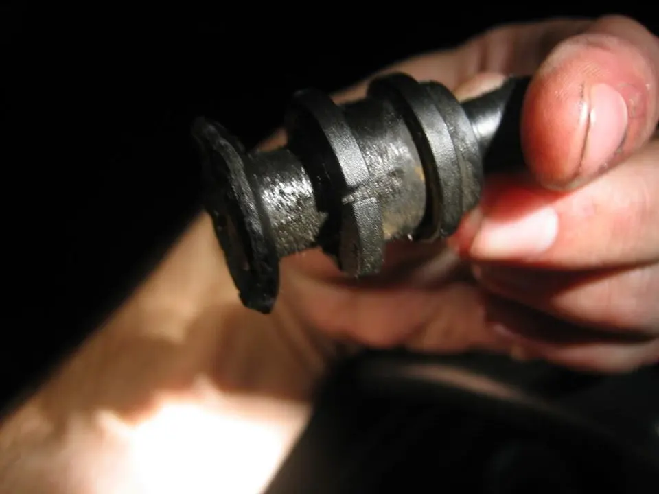

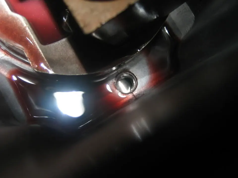

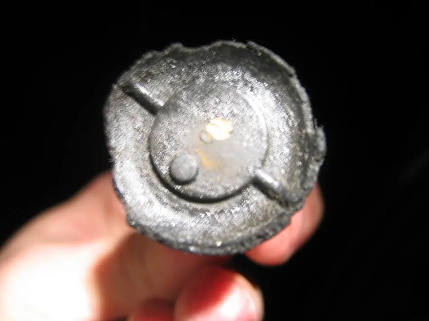

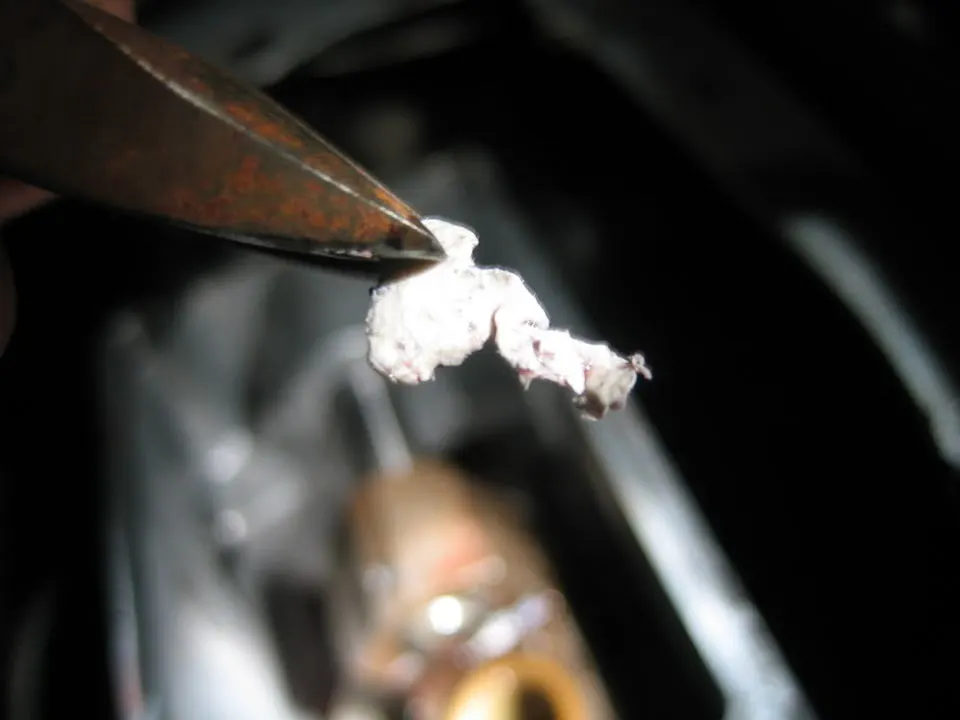

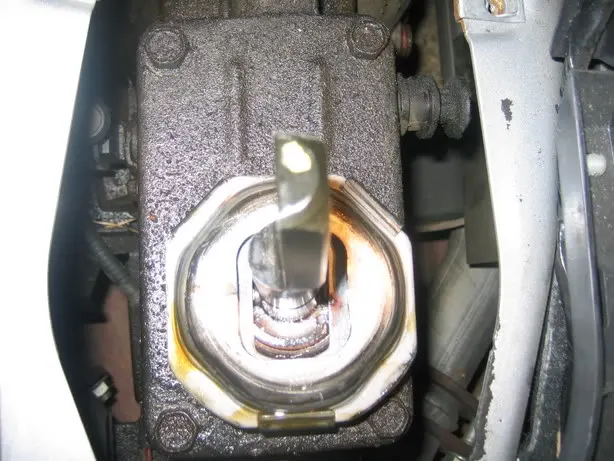

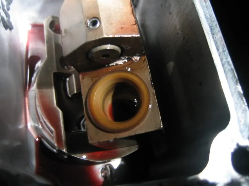

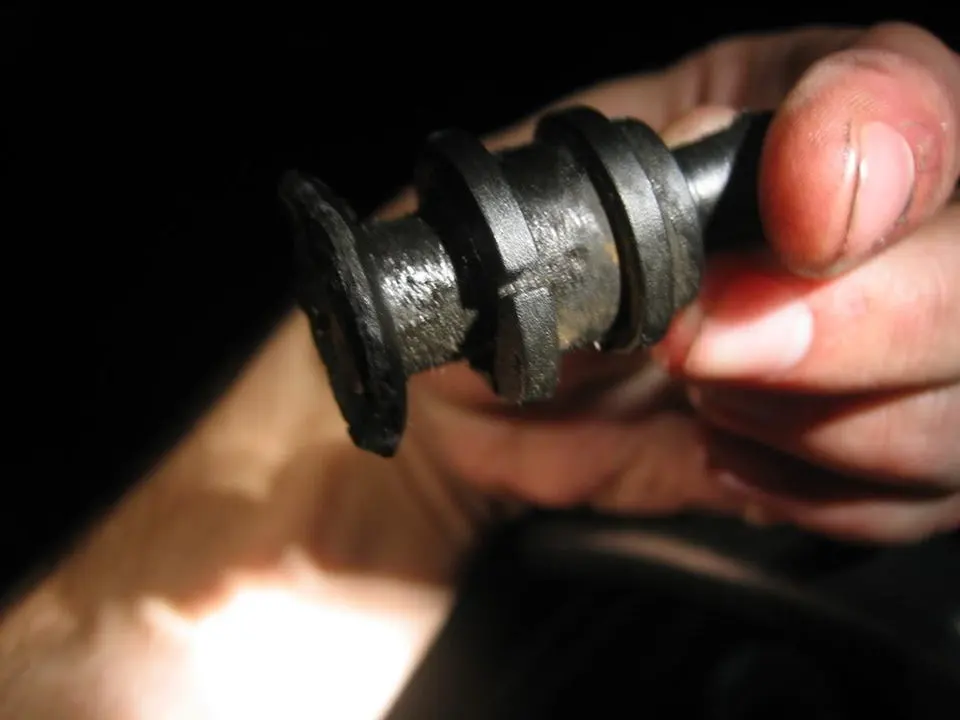

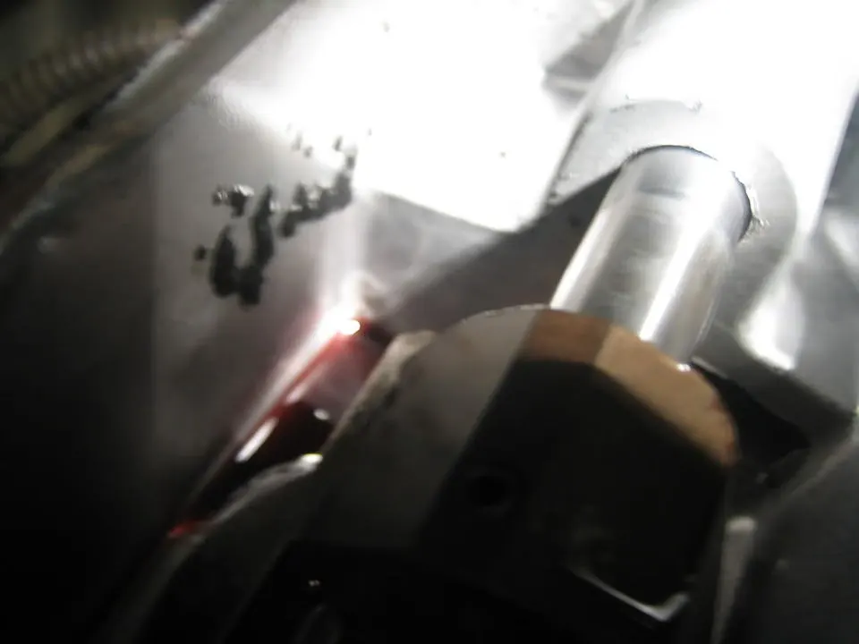

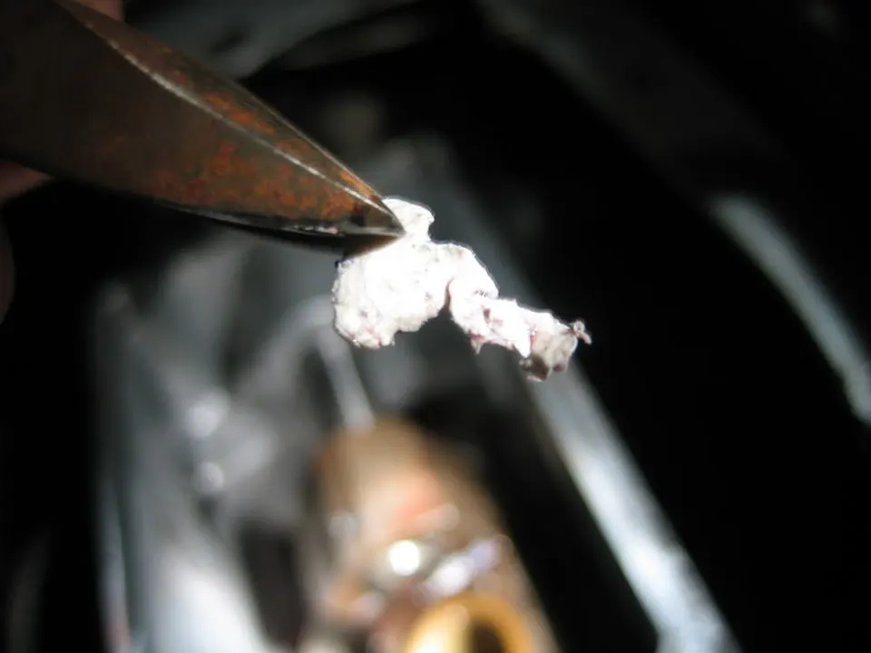

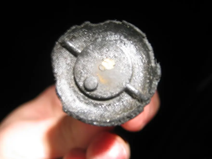

Today when we were under the car we noticed trans fluid leaking from around the shifter area. We pulled the shifter to examine and found what you see here. Notice the black goo on the side which appears to be corroded gasket. The chunk of white plastic was found in the small drain hole at the base. Also, I'm guessing the black rubber grommet type piece is a relief of some sort. Is it supposed to be in this kind of condition? After we reassembled everything I started it and went through the gears with the clutch in... the shifting is now getting more rough and occasionally synchros grind in various gears when going in. What do you guys think? Does it look like I need to start searching for a new trans?
