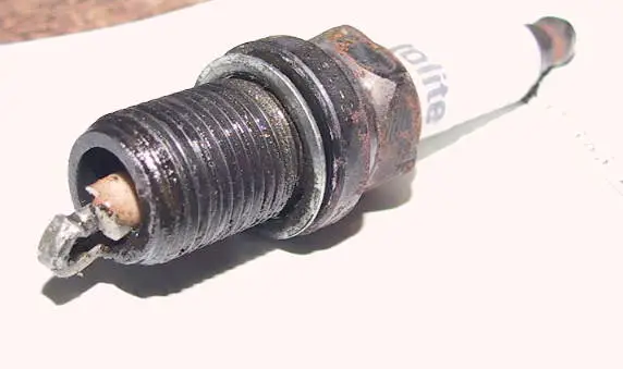

Details...
331 Stroker, #4 cyl I believe <firewall, drivers side> all other plugs were fine, though one wasn't even finger tight :rolleyes:
Should I expect it to happen again? or any ideas of what made it happen?
It was pinging pretty harshly beforehand, which I think I'm safe in assuming this was the problem, lol

Probably just a fluke experience. Not something to happen on a regular basis. The crush ring doesn't look that bad. Probably just missed getting good torque on it. That is a hard plug to get into.
Probably..
The former owner of this car wasn't real happy about tightening bolts it seems... 7 of the lower intake bolts were less than finger tight, and one plug was less than finger tight.... The heads were the only thing tourqed properly I think, lol.
