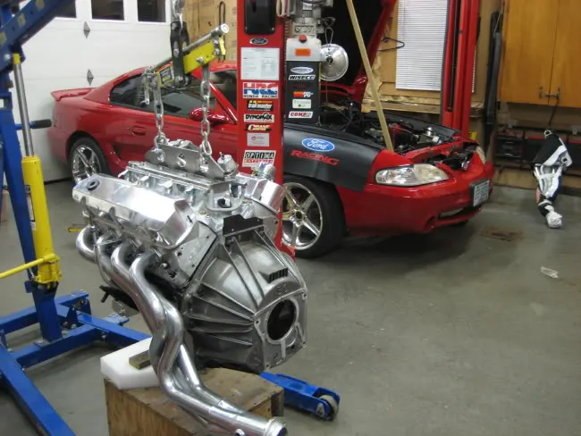

The intake plate works the balls.....especially if the hoist has a leveler... I made this one but they can be had fairly cheap at Summit or Jegs.
