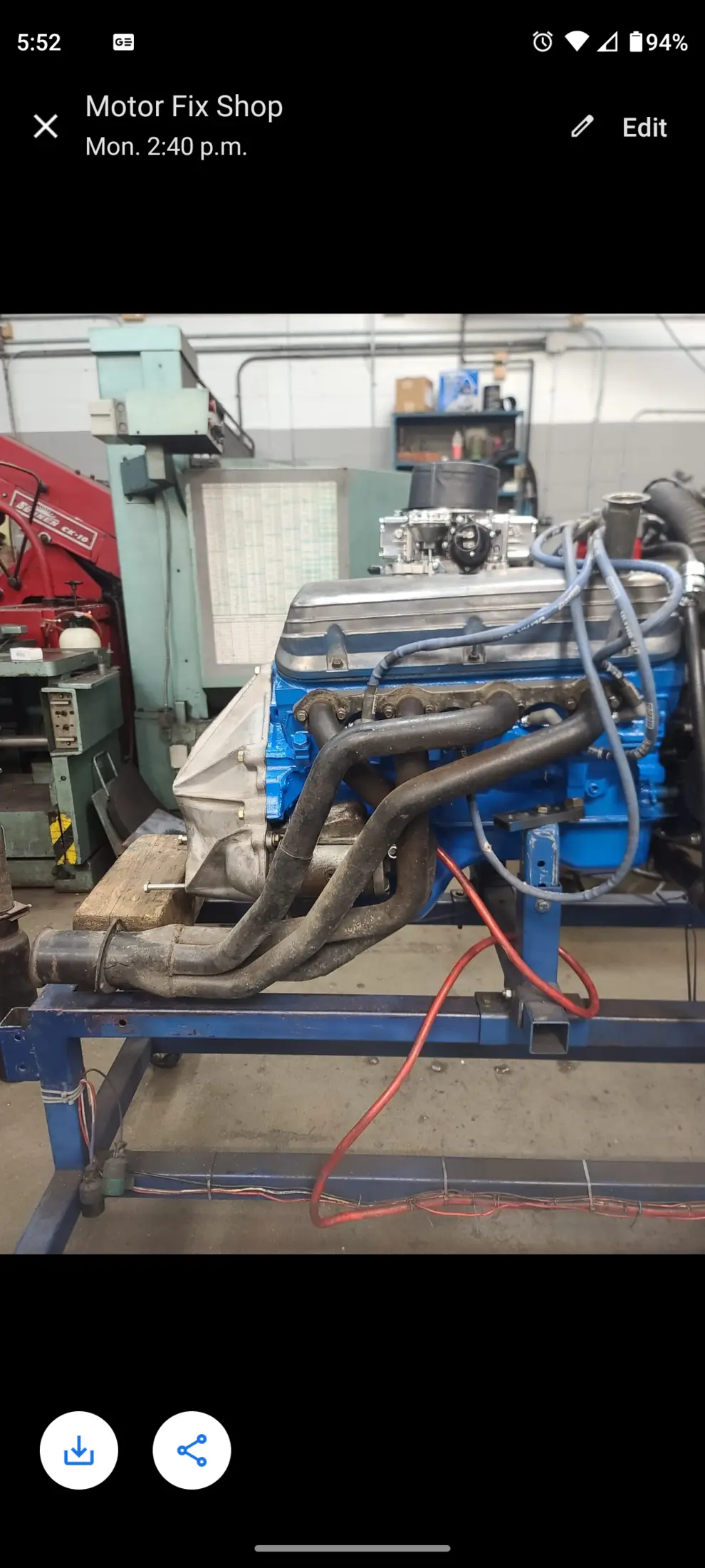

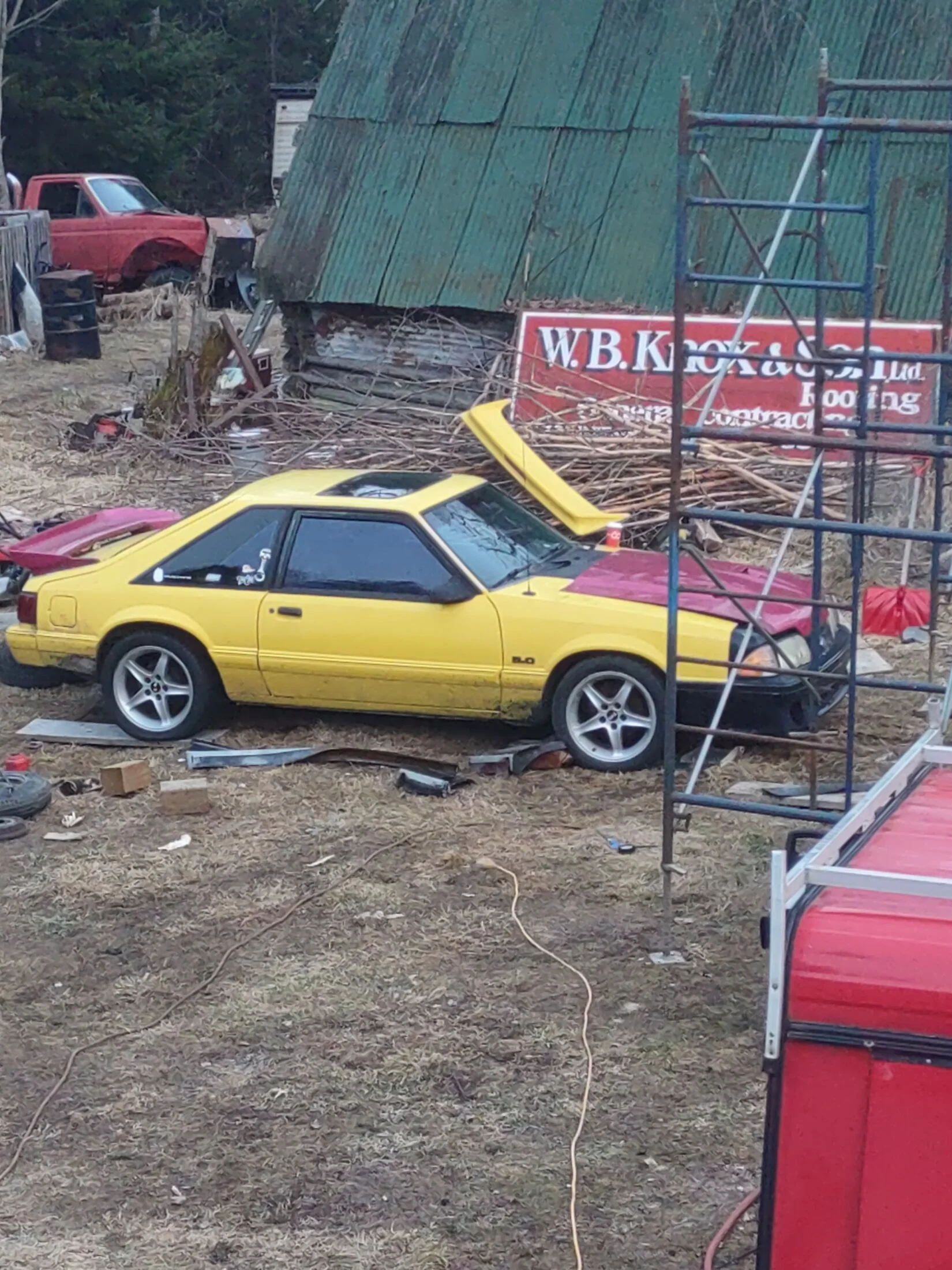

Wondering about location for new pump. Was thinking of the back side of rear bumper. I'm leaving the stock tank. Was thinking that I could leave the wires going to the gage and moving the power and ground to the new pump and leaving the old pump or removing the pump and running a rubber line down to the rag filter. New motor switched to carburetor
