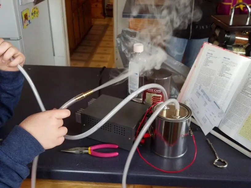

Anyone make an EVAP system smoke machine? Couple pretty good videos on youtube. Thinking about trying the one with the bucket, baby oil, and soldering iron (sounds like the makings of a fun night) haha.
I built this one last summer. Worked great! http://www.pontiacbonnevilleclub.com/forum/general-chat/topic35820.html
This is mine with my daughter helping me test it out. [emoji2]
I'm not sure. I actually found my leak very quickly so I didn't use all the oil that I had put in there. It'll smoke for quite a while. Yes cutting the power kills the smoke. I just flipped the switch on my inverter when I was done. Beware the baby oil stinks when it burns. Lol
Thanks! Maybe I'll use mineral oil. That's what the "real" smoke machines use anyway.
