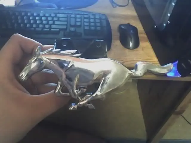

Who has made one? and how? pics? I'm just about done with mine but I broke the tabs off the back of the running pony :mad: so now I have to attach it to the black plastic piece some other way. All I have here is JB weld, and I'm pretty sure that wont work on plastic. Am I correct? SuperGlue wont hold if it gets wet, any suggestions? I'll upload my crappy camera phone pics here in a little bit of how I did mine.

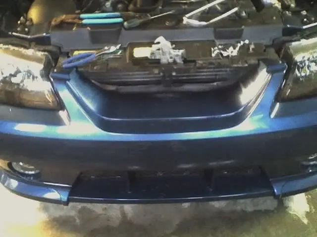

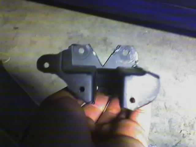

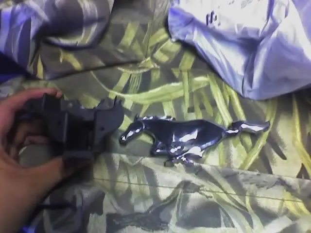

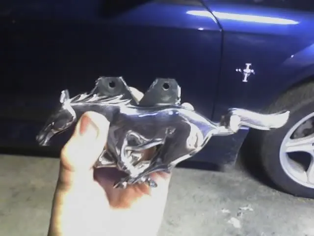

ok heres some pics. i first took the 2 screws out to get the pony/corral off ( i didnt have a grille). in the process i broke the little posts off the back of the pony, so now theres nothing to hold it to the plastic piece. i removed the corral, and trimmed the plastic piece so you wouldnt be able to see it sticking up around the edges of the pony.
^^thats before i started trimming^^
^^the pony removed from the plastic backing^^
^^empty grill^

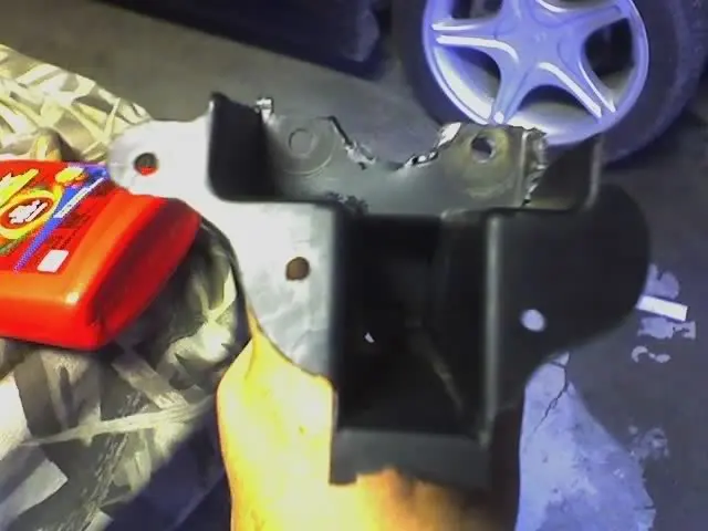

^^after i started trimming the piece down^^
^^thats what it will look like^^
^^thats it right now^^
im going to trim it so it doesnt look like a "V" in the back of it there. does that help some of you understand a little better?
Super glue has held mine on for almost 2 years now :shrug:
I had to take my pony off my stock one and put it on a Roush bracket, so i basically glued the back of the pony to the bracket. and i put rubber bands around it all while it was drying for a few days then cut them off. still is working for me :D

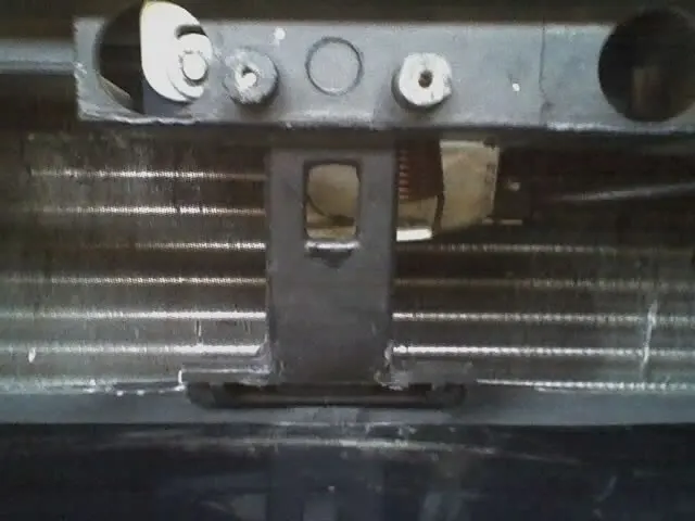

I just cut the pony out a long with the black piece behind it. I used the horse as a template for cutting out the black piece. Then I removed the locking washers that hold the black piece to the back of the pony. I drilled the black piece that was behind the pony in the middle. After that I put a bolt through it and through one end of a double L shaped bracket then tightened it down. I then reattached the pony to the black piece using the original locking washers. After this I drilled the header panel directly behind where the grill was and attached the opposite end of the L bracket to it using another bolt and nut.. Took less than an hour.
Kinda like this
Pony-bolt-black piece-|-wingnut--------------bolt-|-header panel-Nut
----------------------------|______bracket...______|------------------------
