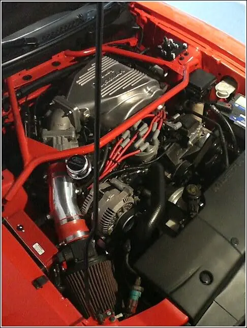

It would be cheaper to buy the AFM steel chrome dipped valve covers for $75 rather then spending $600+ on a hood, paint and spacer. I run them with a Holley Systemax which I was told would never clear the stock hood and it did. Tall valve covers are a killer sometimes.
