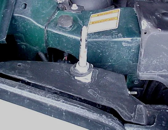

Here's the ugly chop job. But, at least it gets the job done. I have to come up wih something to cover these pins in order to make hem loof presentable...

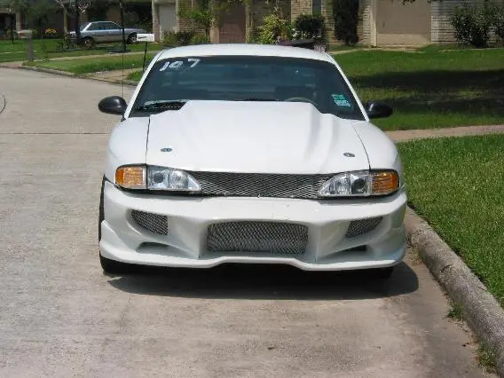

attachment.php
I hate winters here!

:shrug: wow that sucks, I put some on my '78 camaro the other day and it took about 2 hours. I didn't measure anything, I just put a dab of paint on the top of the studs and lowered the hood gently, drilled a small hole through the middle of the paint (from the bottom) and then finished it off with a big bit through the top. My hood appears to be two layers, but I had a more convient place to mount them i guess.

is that your car?...............no offense but you need to a.) get a new bumper or b.) re-mount it cuz its about to fall off from the looks of it

I thought it would be cool to have pins on my '90 with the stock hood. That was a dumb idea, it took me around 6 hours to install them. I put the in the radiator support...that was the easy part. Getting them to come up through the hood so it would close right was the hard part. I had to smack them around with hammers several times to get them finally straight. Ugh. Trying to get them to go straight through 2 layers of metal about a half inch apart isn't that easy. My hole-drilling method was pretty straightforward though. I just installed the pins and dropped the hood on them. Presto, the holes were "center punched" and ready to drill.
