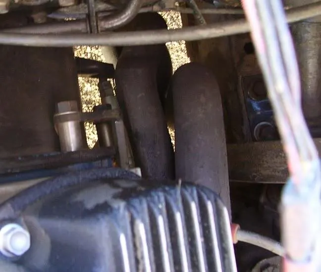

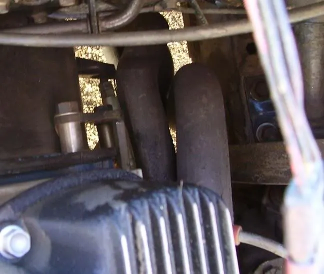

This is the only picture I have. It's raining outside, so I'm not getting any from under the car. ;)

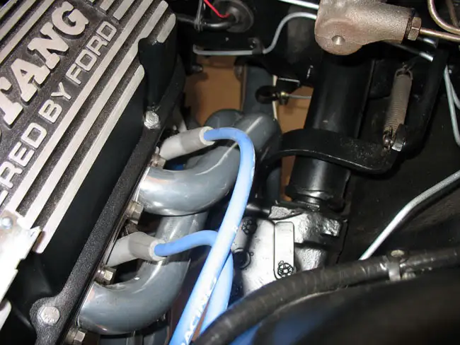

If you guys had 351w you wouldn't have ground clearance issues (extra 1" deck height) :lol: I have Hooker Comps that are coated inside and out and they are great. A few dents here and there to clear steering components is all that is needed. I do have some clearance issues with the header reducers near the transmission cross member support. The headers are tucked almost too high and the header reducer had to be dented to get it to clear. I have the 2.5" Magnaflow stainless exhaust kit.

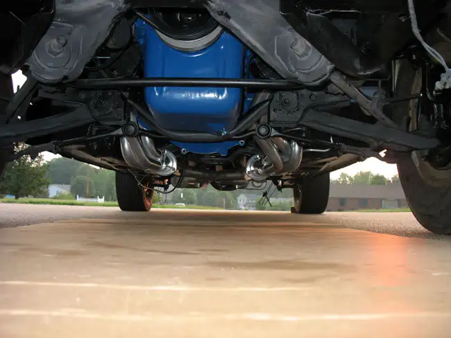

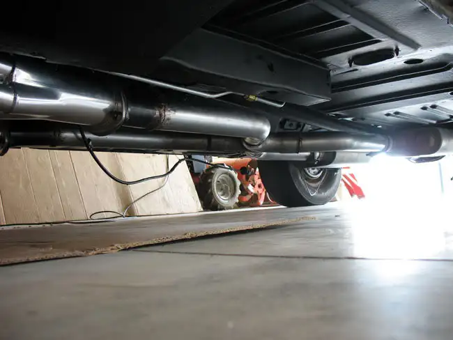

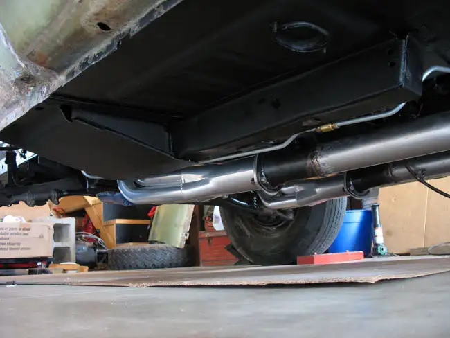

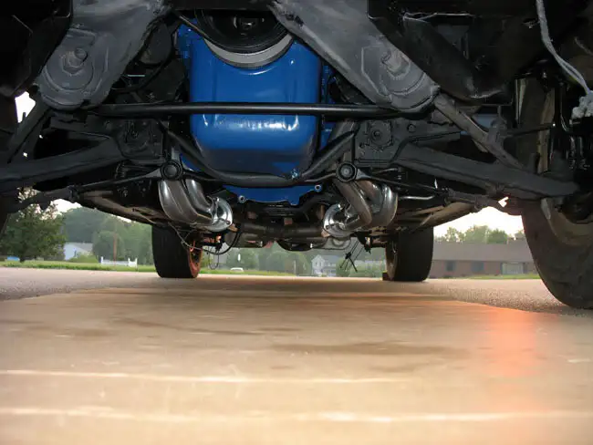

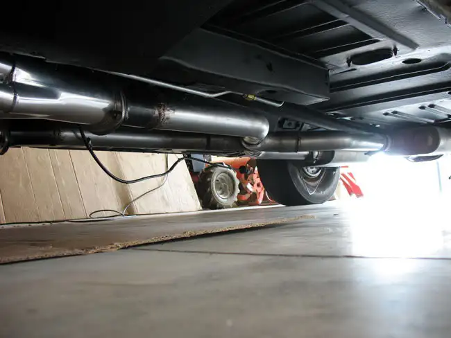

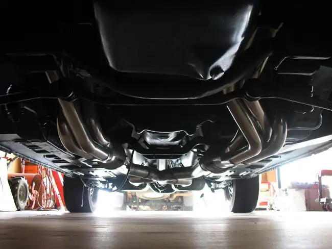

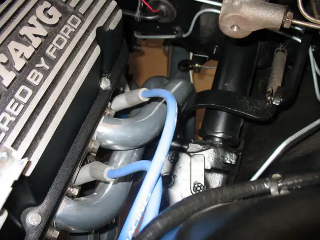

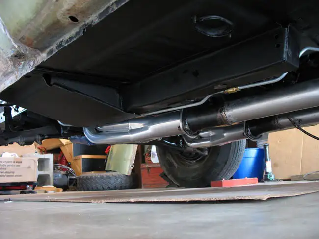

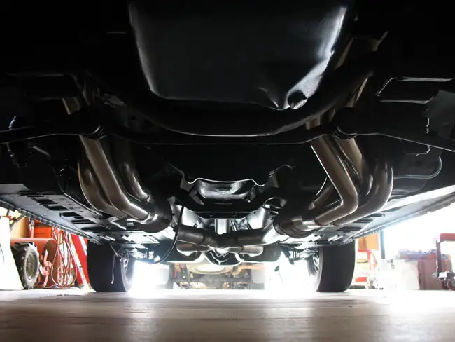

I've got some pictures. This is on a 67' Fastback with a 289 and a Toploader. I didn't take pictures with a can but i measured the lowest point which happened to be the collector flange at 7". There's no interior in the car, but i doubt that will drop it too much more if it was in there. These 6901's fit perfect and we didn't have to raise the motor either. It might be different for your 65'. The instructions say if you have to do some modifications to the headers, if you can believe them.
