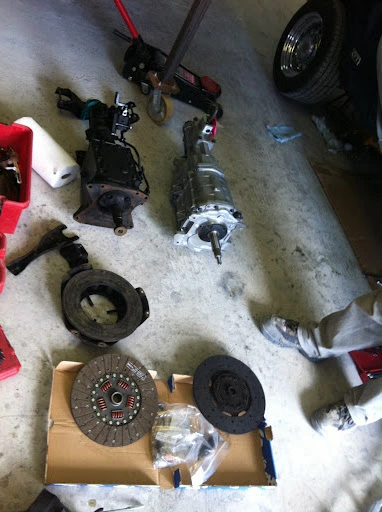

Dropping out the old crossmember and transmission was a piece of cake. The bellhousing for the 390 has an access plate that lets you drop the clutch out without removing the bellhousing. The old pilot bushing popped out with little effort.
Here's the old one out and the new one ready to go in. You can see the 5spd is considerably larger.

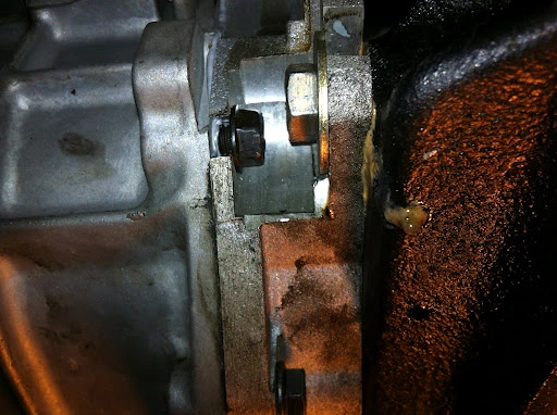

The overall clutch assembly was still thicker than original and wouldn't install through the bellhousing access plate, so we had to back off all the bellhousing bolts by 1/4" (the top 2 are nearly impossible to get a wrench on to) to get additional clearance. Don't forget the clutch fork... we did the first time. With long tube headers, it won't install from the side.

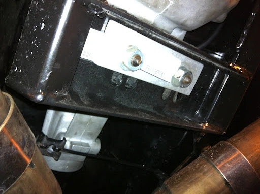

Next, the new crossmember goes in. It bolts in the original location but then sets back several inches. Luckily it just clears the Dynomax exhaust pipes.

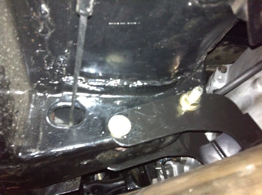

In addition to the original set of holes, the cross member requires you to drill a 2nd set in the rib across the tunnel. Another challenge, as these holes interfere with the dimples on the underside of the rib... the bolts just barely fit.
It really looks like the cross member wants to be about 1/4" higher, but this is where it locates with the stock holes.

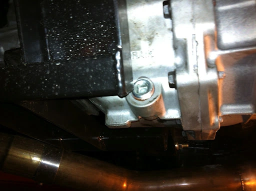

The drain plug looks obstructed too.

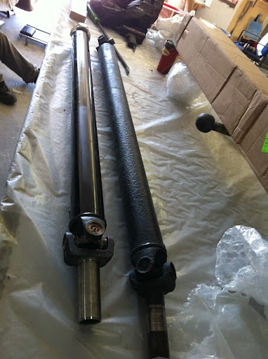

New driveshaft vs old. Good fit (longer case on the 5spd, so shorter driveshaft).

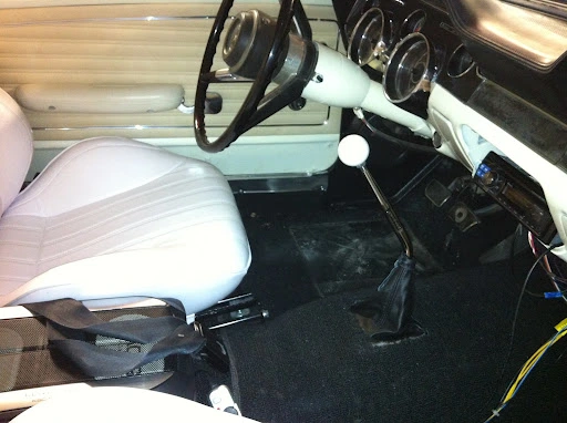

Finally, shifter arm goes on, and we get the car out the door! It took an extra half day, but compared to some jobs, I'd have to say it went fairly smoothly.
The shifter location is nice, but its a pretty long throw ... in time I might put on a shorter arm.
