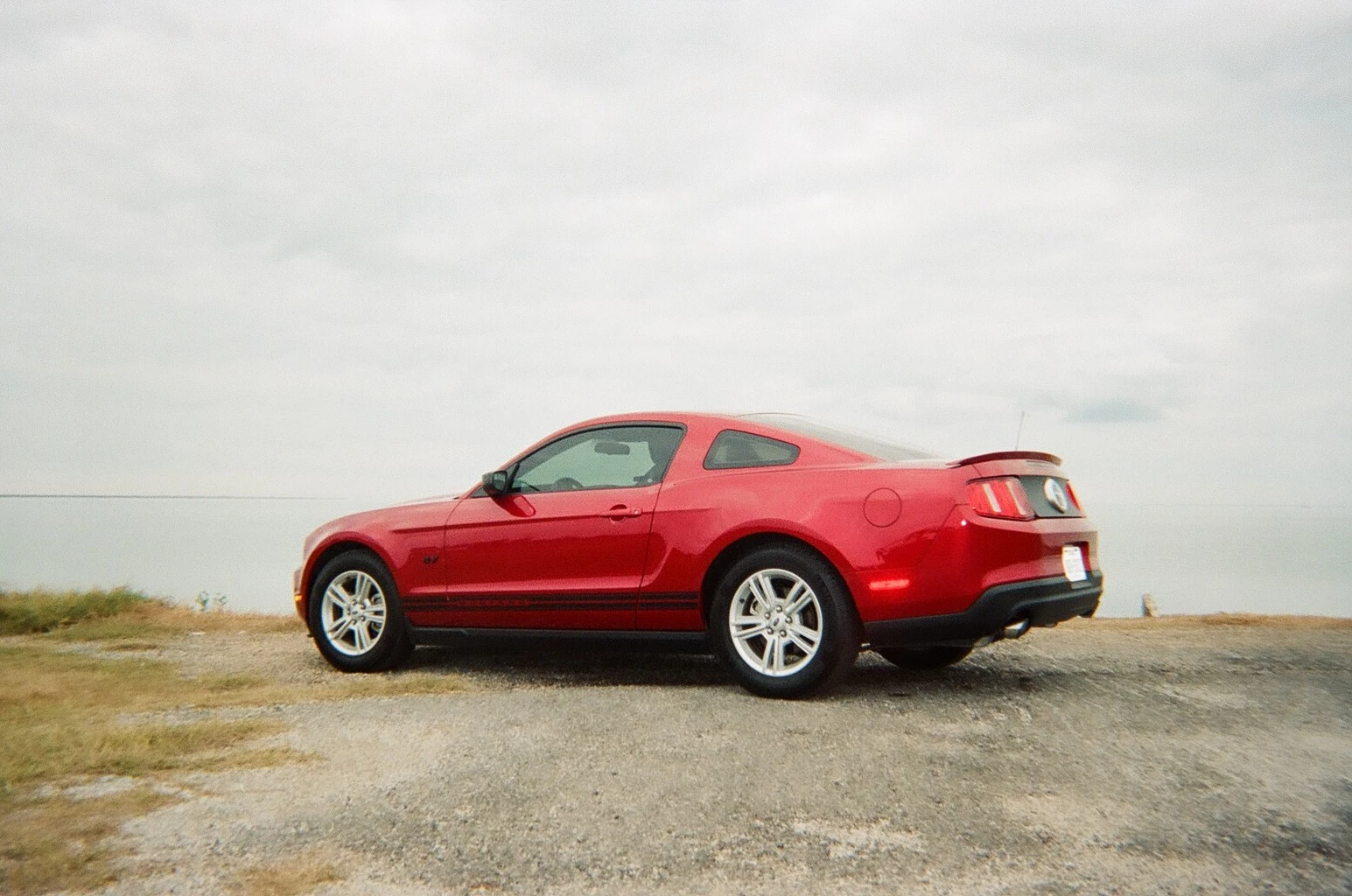

I too don't want a too low drop in the front. I am going to install SR Performance springs on just the rear
of my pony. Has anyone else done just the rears??
