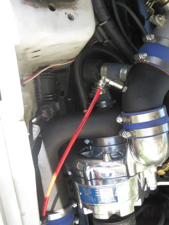

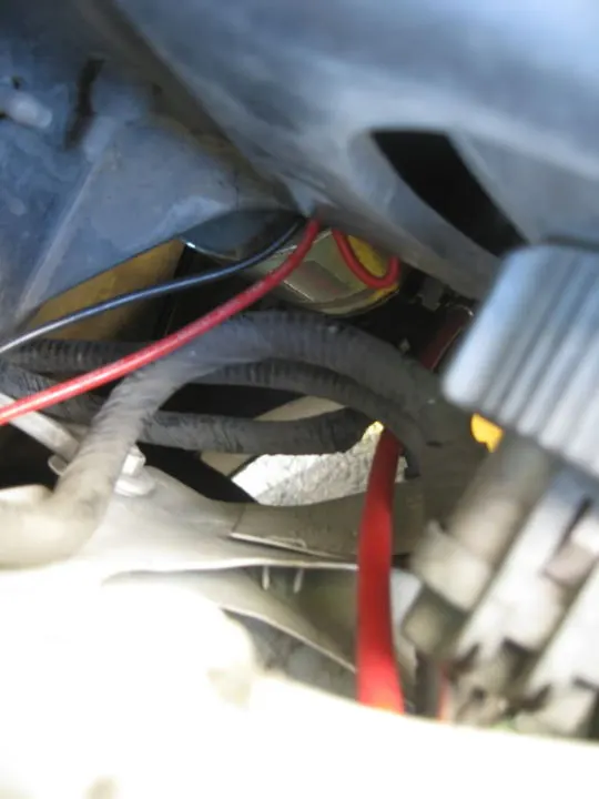

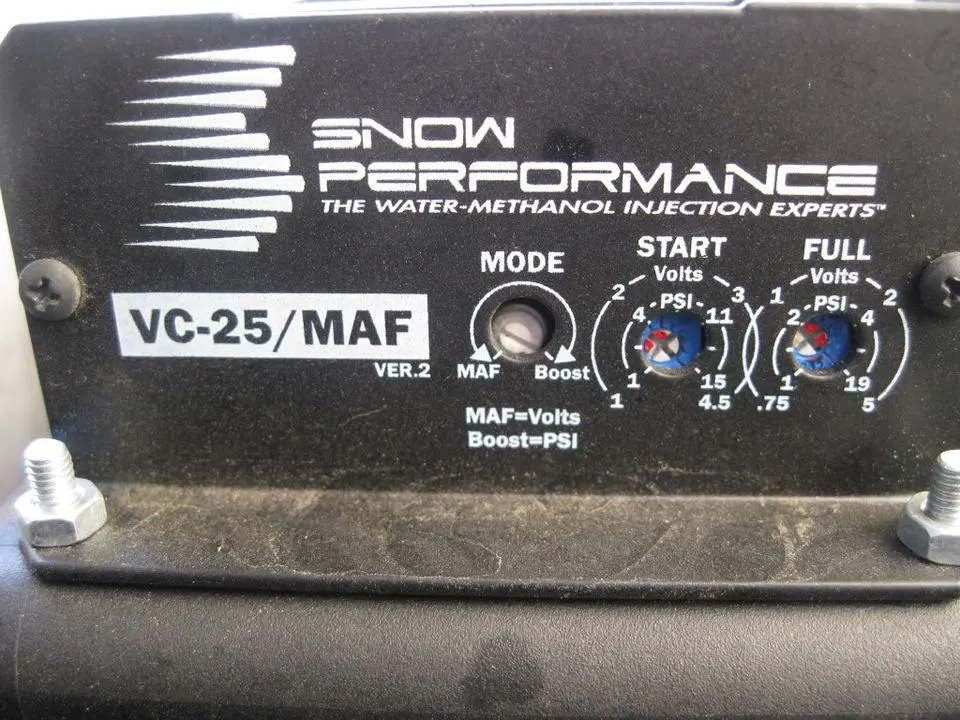

Here are the pics, one of the box to controll the methonal, the pump behind my headlight and the line to the intake.
My methonal isnt pre mixed, i just bought a galon of it and mixed half with distilled water. they also said you dont have to use a 50/50 mix. but its safe at 50/50. i know a few people who run 90/10.
To the OP, when do you have yours set to come on? as you can see mine is at four pounds.

Mine comes on at 3psi and goes full spray at 14psi. My kit does not have a low level sensor, but they do offer that now.

nice I just want to drive my car and not be scared of the trans blowing up on me. seems like this isnt the place to skimp either, so im saving up for a nice little set up.
Im glad i can help, yeah mine just comes on! lol, i tell you when it hits it feels like a little shot of nos but then again the boost is building so its the whole experiance.
I dont want to explain the methonal to anyone when i pop the hood so i figured thats the best route. along with not moving anything I still have the tank though. not sure what to do with it ;p

Sorry for the delay, mine has a pump and goes after the blower. Dont want methonal running around inside my blower ;p
There are so many different ways of using methonal. this is just the easiest one for me.
