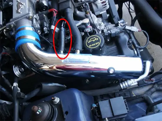

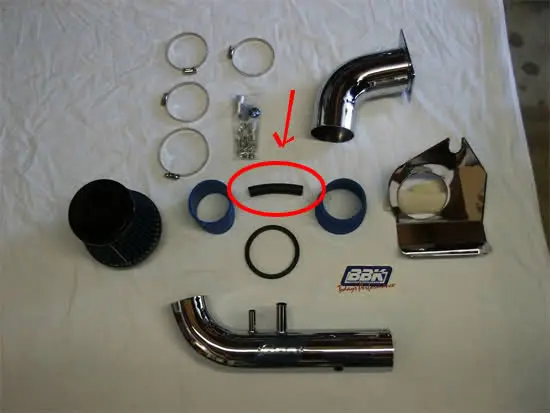

You're talking about the plastic tube that runs across the motor over into the drivers side head?
The BBK should have came with a rubber hose to join that plastic tube with the CAI (pictured below)
If you kit didn't come with one (for whatever reason), then yeah you'll need to go buy a hose.
