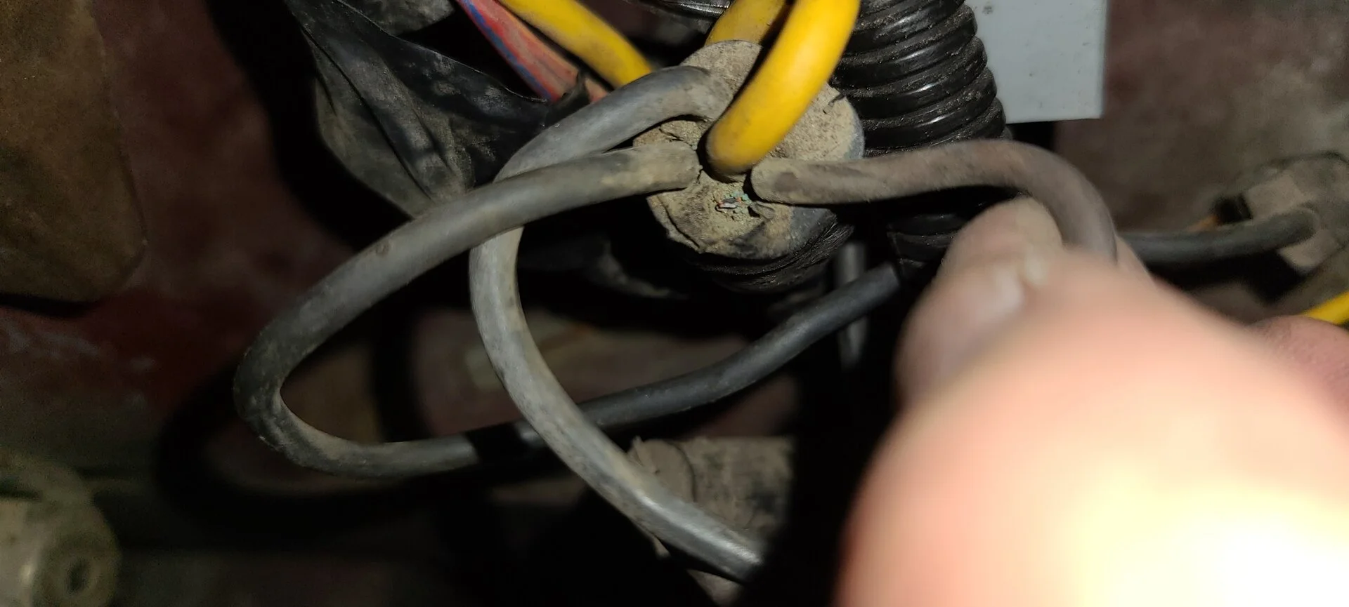

I have a wire that corroded, then burnt into. As you see in the pic not much to work with. What is this round block called? And how does one replace it?

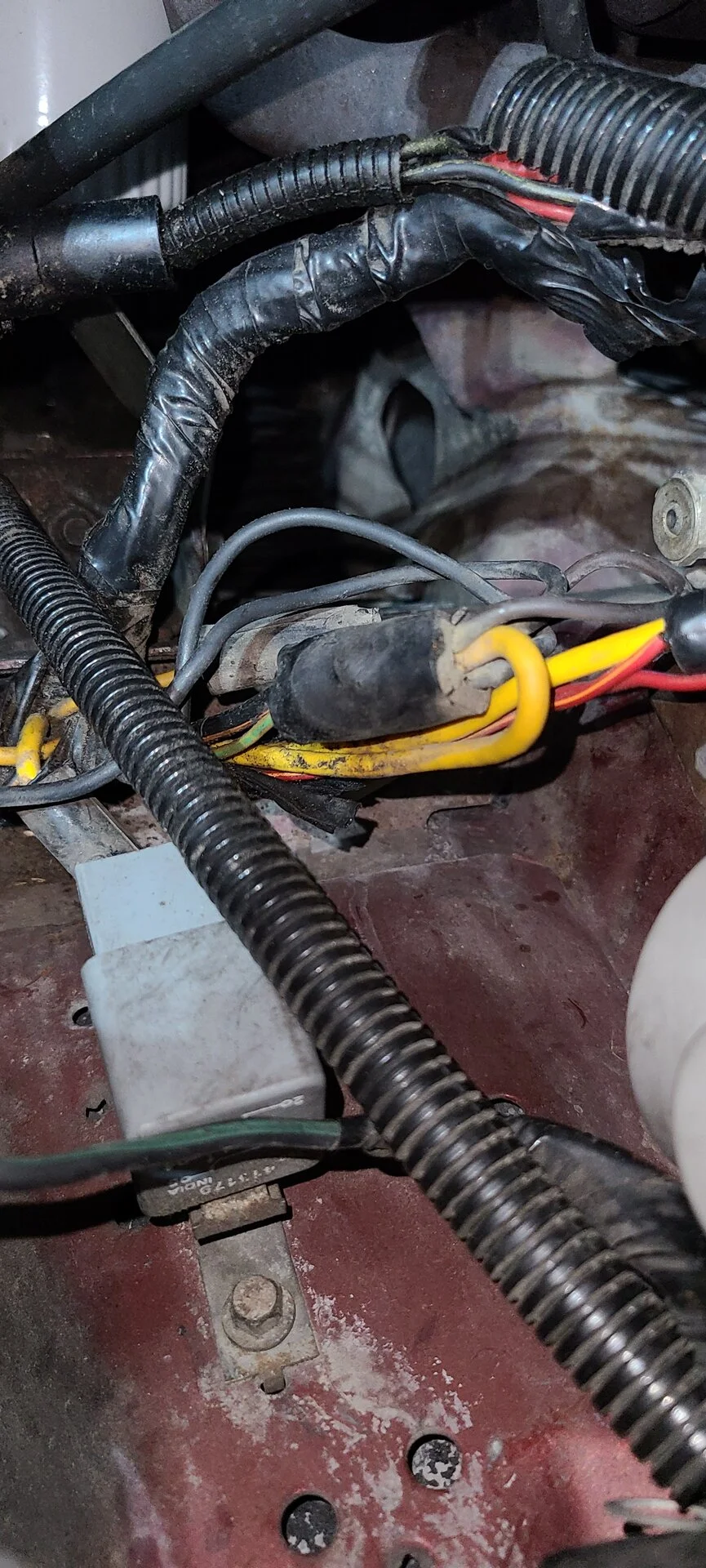

1986 GT, right below the solenoid. Their is a series of fuse links. This particular one has 5 wires going into it, counting the one that corroded out, and two wires coming out. I believe the wire that corroded and broke is the hot wire to my ignition. Because I have no power on my ignition. Thanks.
The fuse links for all model years 86-93 live in the wiring harness near the starter solenoid.
