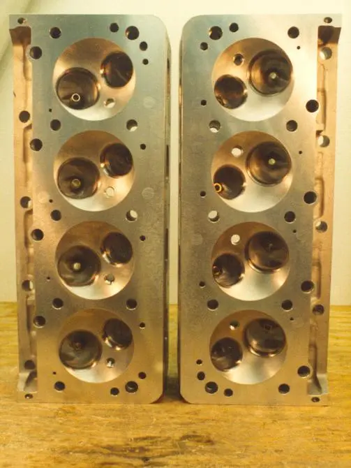

There is probably a reason aftermarket companies didn't continue with the cleveland heads. With the huge valves and ports, velocity was down at low rpm. You really have to rev them to get to the power band. Modern head design factors this in and you have more useable power. I know www.powerheads.com sells cleveland heads. This brings me back to the boss 429. The engine is very powerful stock, and how it looks is great.
Hemi type heads, they make the whole engine look meaner and bigger. I wish the aftermarket made such an offering for the windsor motors.
