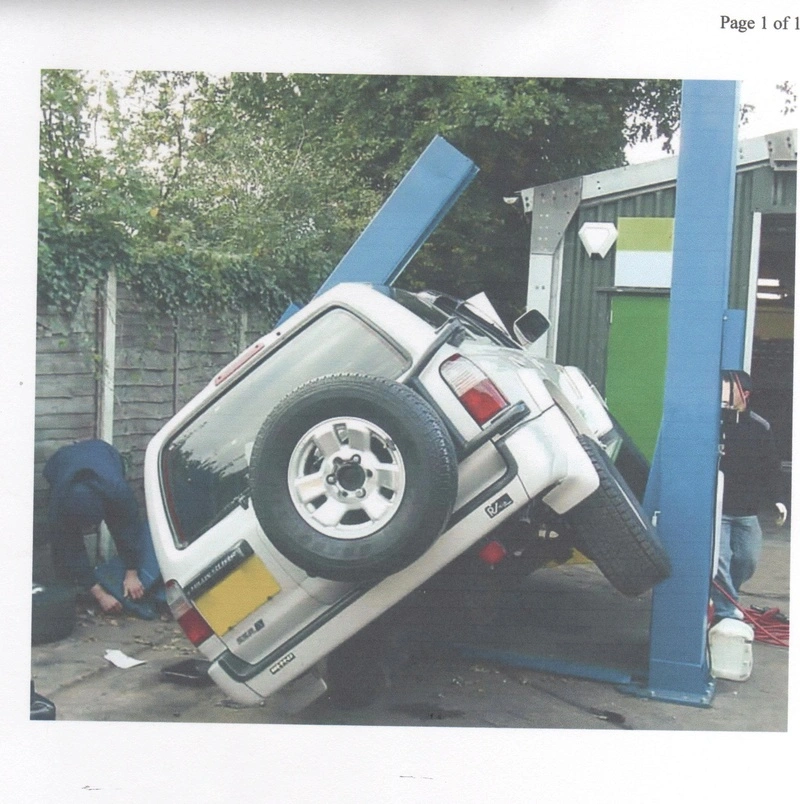

I have a pic of a 2-post which pulled it's anchors or broke the floor, dropping a full-sized Bronco over on it's side. So, are THEY safe?

Thank you for that. You are absolutely right about the concrete. It needs to be properly loaded with reinforcing steel, and no home garages are. That's why I'm leaning away from a 2-post. Couldn't find the pic of the crunched Bronco; I'll try again tomorrow. imp

@74stang2togo Aside from the vehicle damage, chance of being killed while working. Not the fault of the lift; concrete failure. imp
